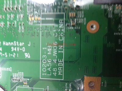

Lenovo laptop b560 dim display
Replaced screen
Replaced cable
No sucess
In motherboard lvds f2(fuse) is getting heated
Please help

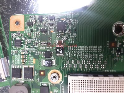

rahulsan
Posts: 26
Re: Lenovo b560 dim display
Post by rahulsan »
Seems leakage capacitor shows 12ohms
riyas
Joined: Thu Apr 21, 2016 10:36 am
Post by riyas »
first chk display cable for burn internally bcoz main power of lcd 7v to 21v supply shorting.may be problem solve
rahulsan
Posts: 26
Post by rahulsan »
Problem solved 1 cap shorted near lvds fuse
