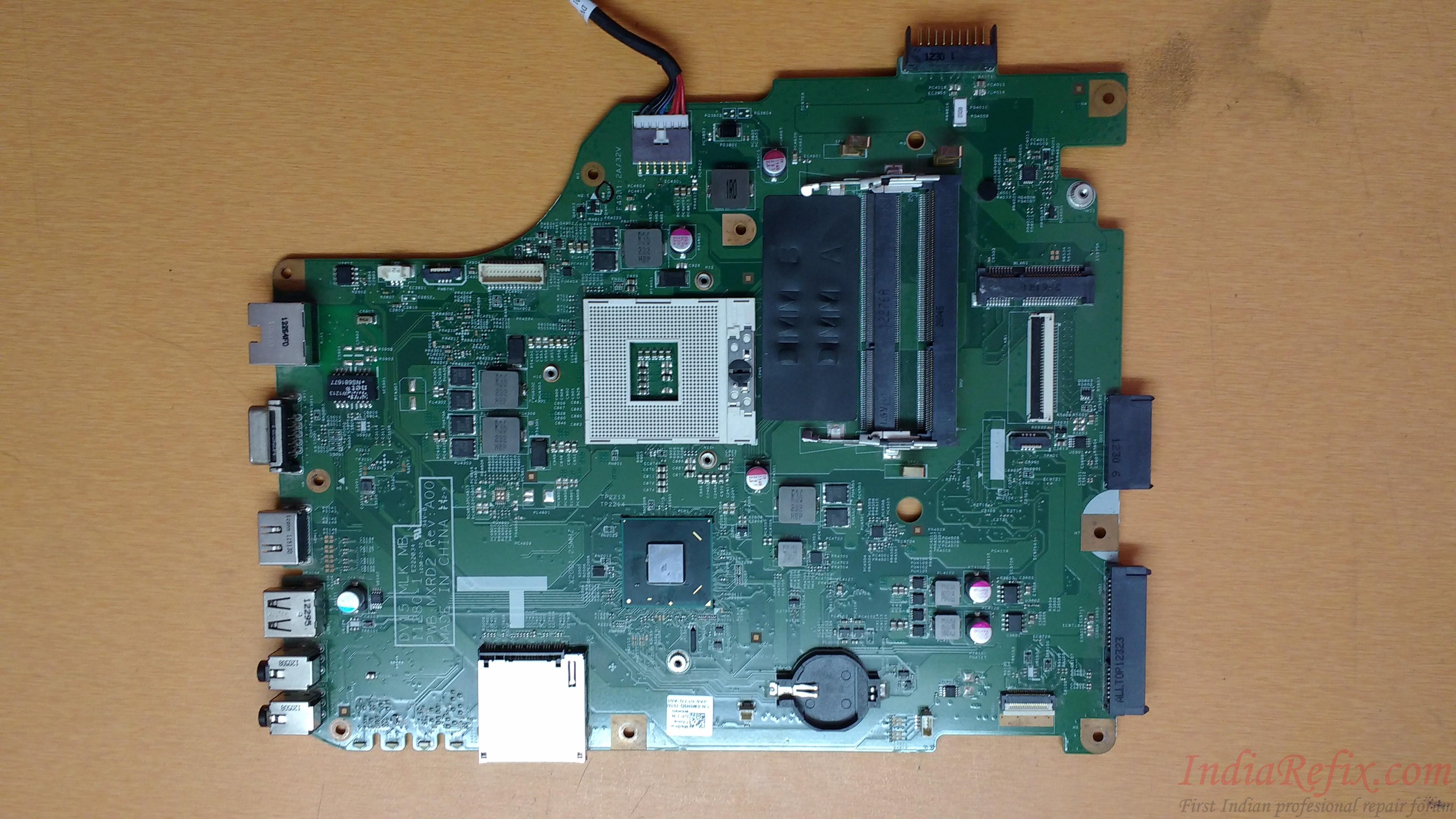

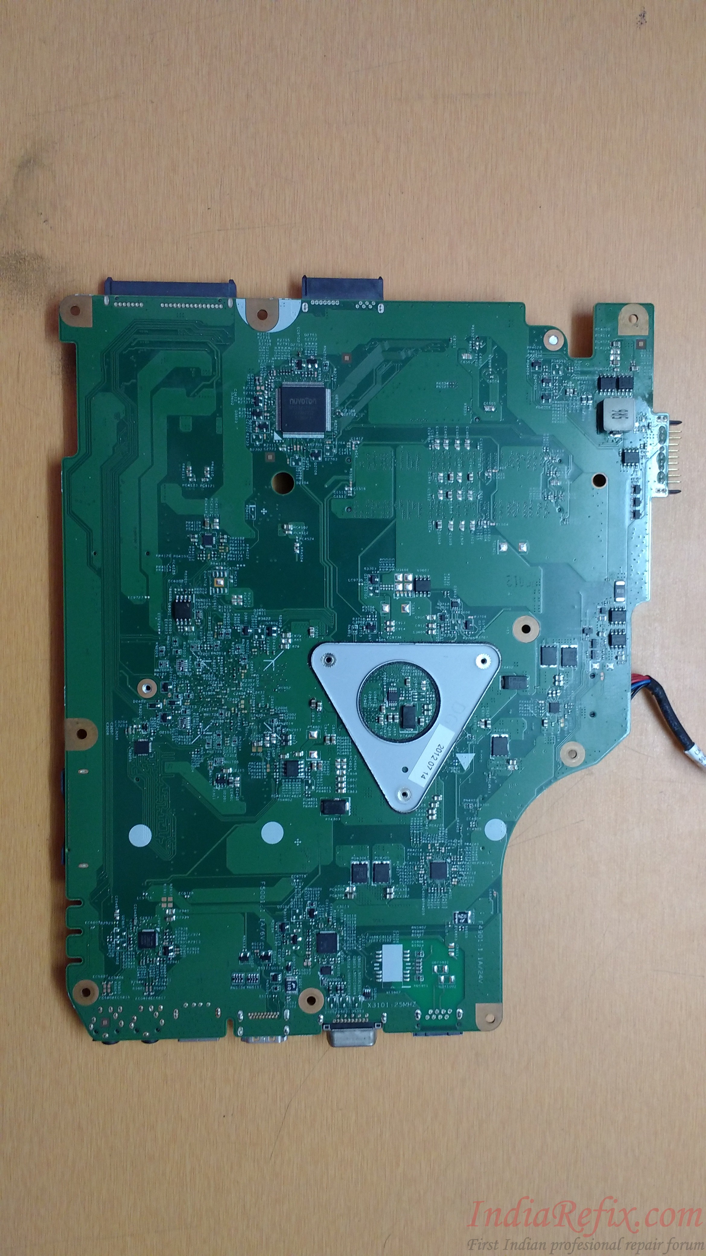

upload motherboard part no and motherboard pic both side

DELL INSPIRON 3520
BOARD PART NO :
DV15MLK MB
11280-1
PWB:MXRD2 Rev:A00
