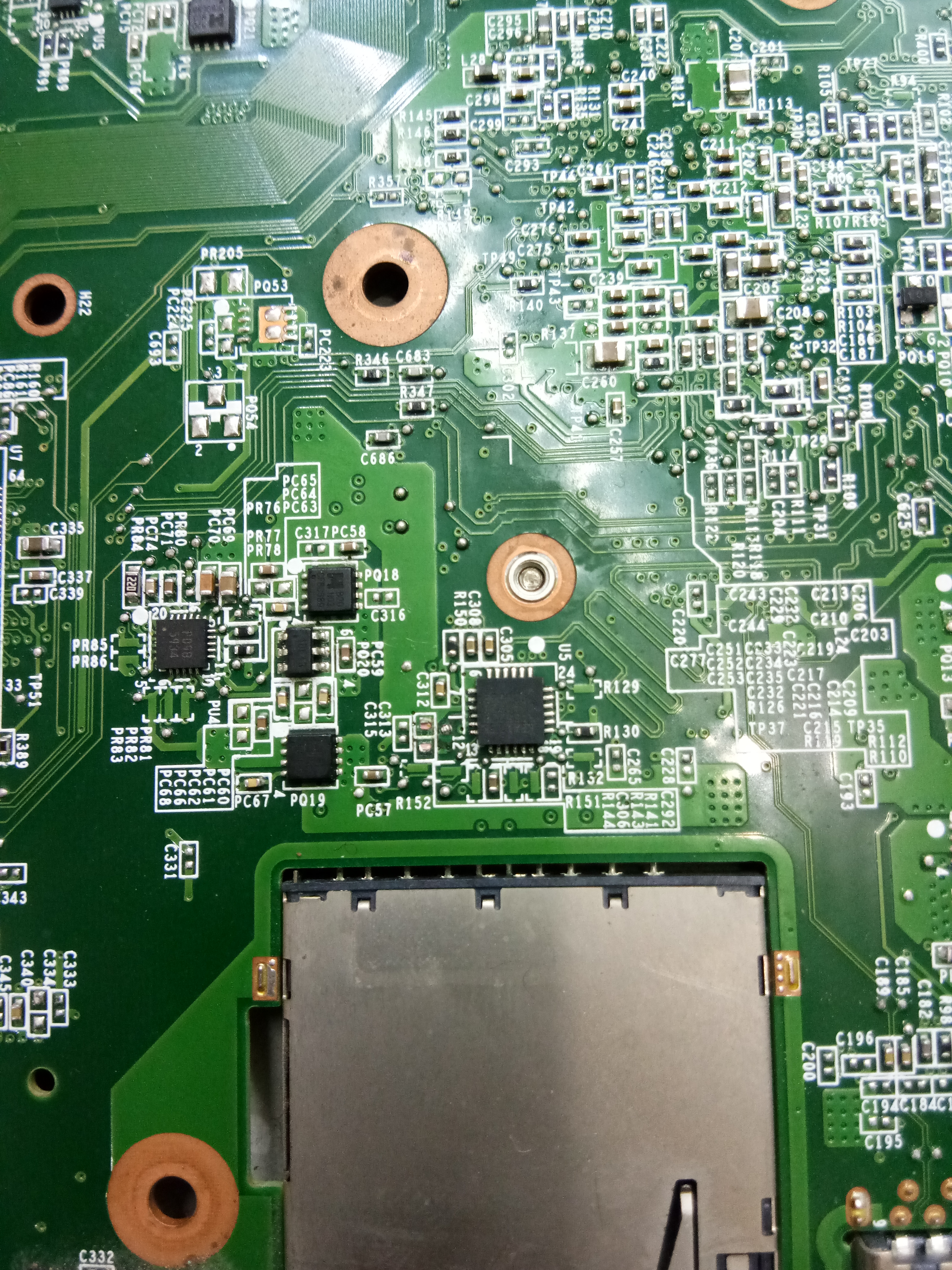

no power on 19v supply ok no 3v 5v nthing happend then i found capasitor short near sdcard ic i remove and put new capacitor then all supply r working laptop on display ok.....

c313, good work
