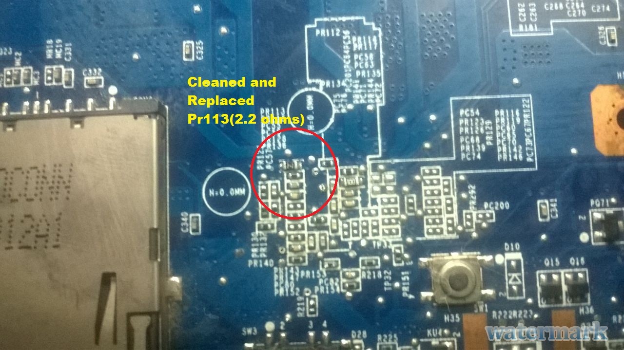

Laptops comes with not display condition …
Symptoms PSU takes a load on 0.33 Amps and power trips off
Checked for 3.3 /5v regulator Found no issue with voltages

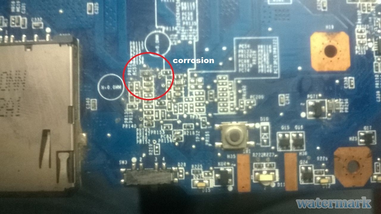

On physical verification found Corrosion in the Vcore section ..
Cleaned the pads and Replaced PR113( 2.2 ohms) which is 19v
Supply to Vcore IC….
Job done
