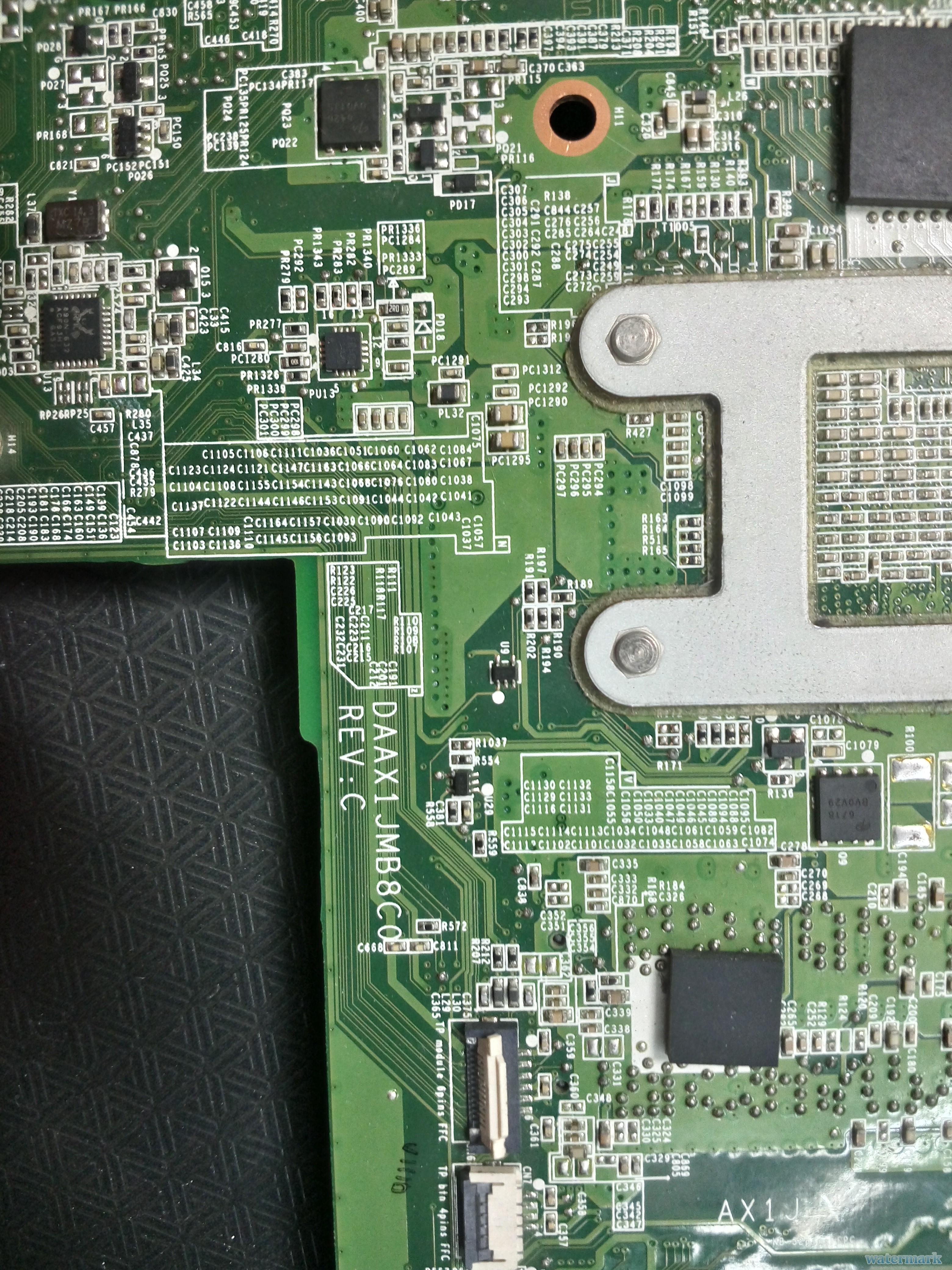

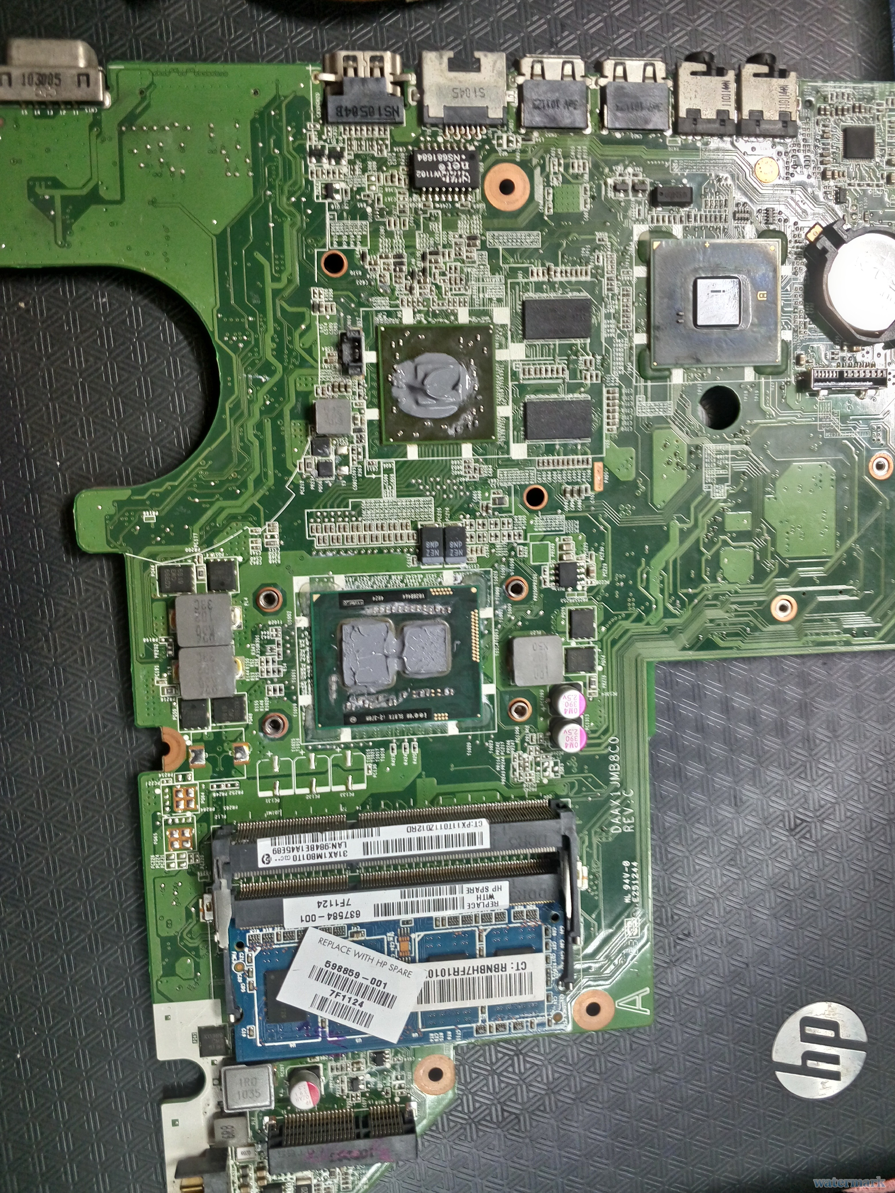

MODEL HP G42-478TX
PART NO DAAX1JMB8C0 (AX1J)
CPU SLBTX I3-370M
GRAPGIC IC ATI 216-0774207
PCH HM55
I/O ENE KB39260F D2
POWER ON NO DISPLAY EVEN NO POST CODING (DEBUG CARD)
REBALL GRAPGIC IC ATI 216-0774207
THEN ALSO NO POST CODE(DEBUG CARD)
AFTER THAT REMOVE FAN WITH HEATSINK FOUND CODEING AND DISPLAY TOO THEN SAW SELF PROTECTOR OF MB WAS MISSING ( plastic protectors) :shock:
