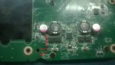

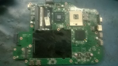

Got th e laptop in no power condition
system ic handled already ..
Still a short in 5 V line ...
Found PF short ..
replaced and job done
here r the pics
