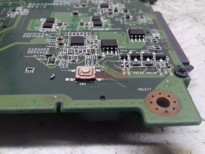

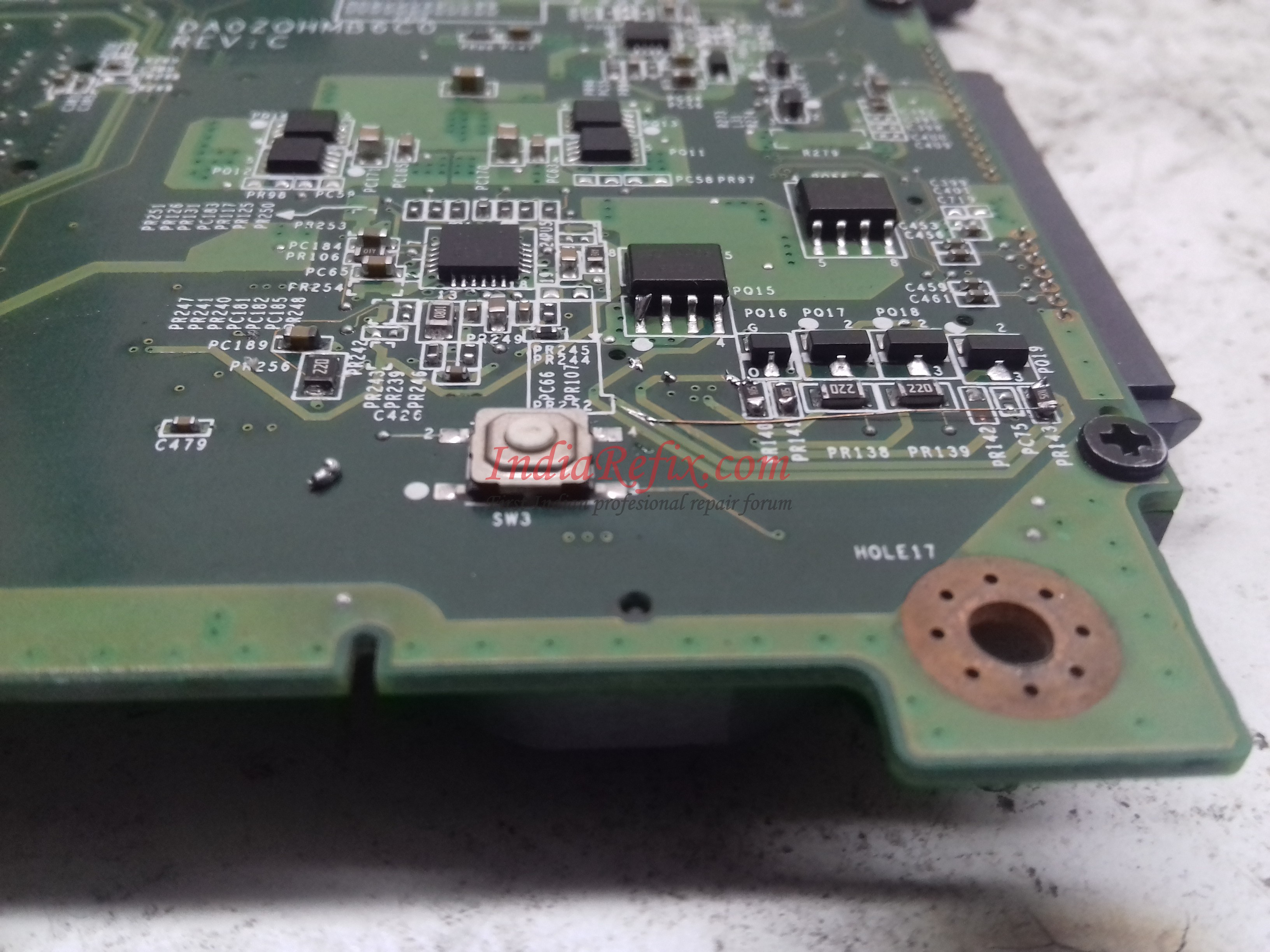

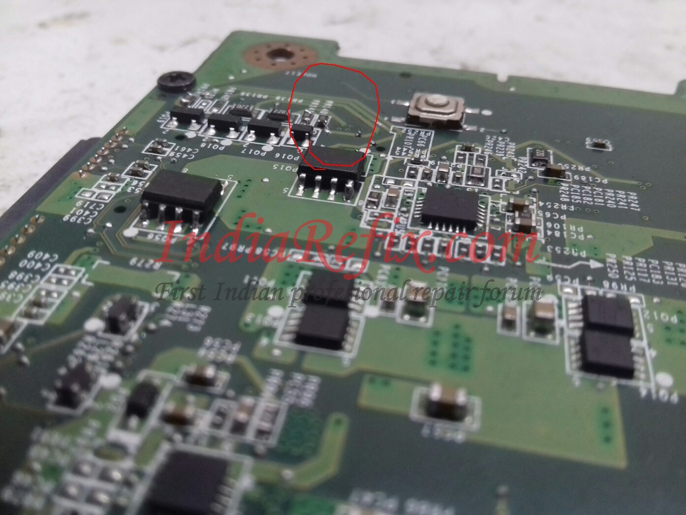

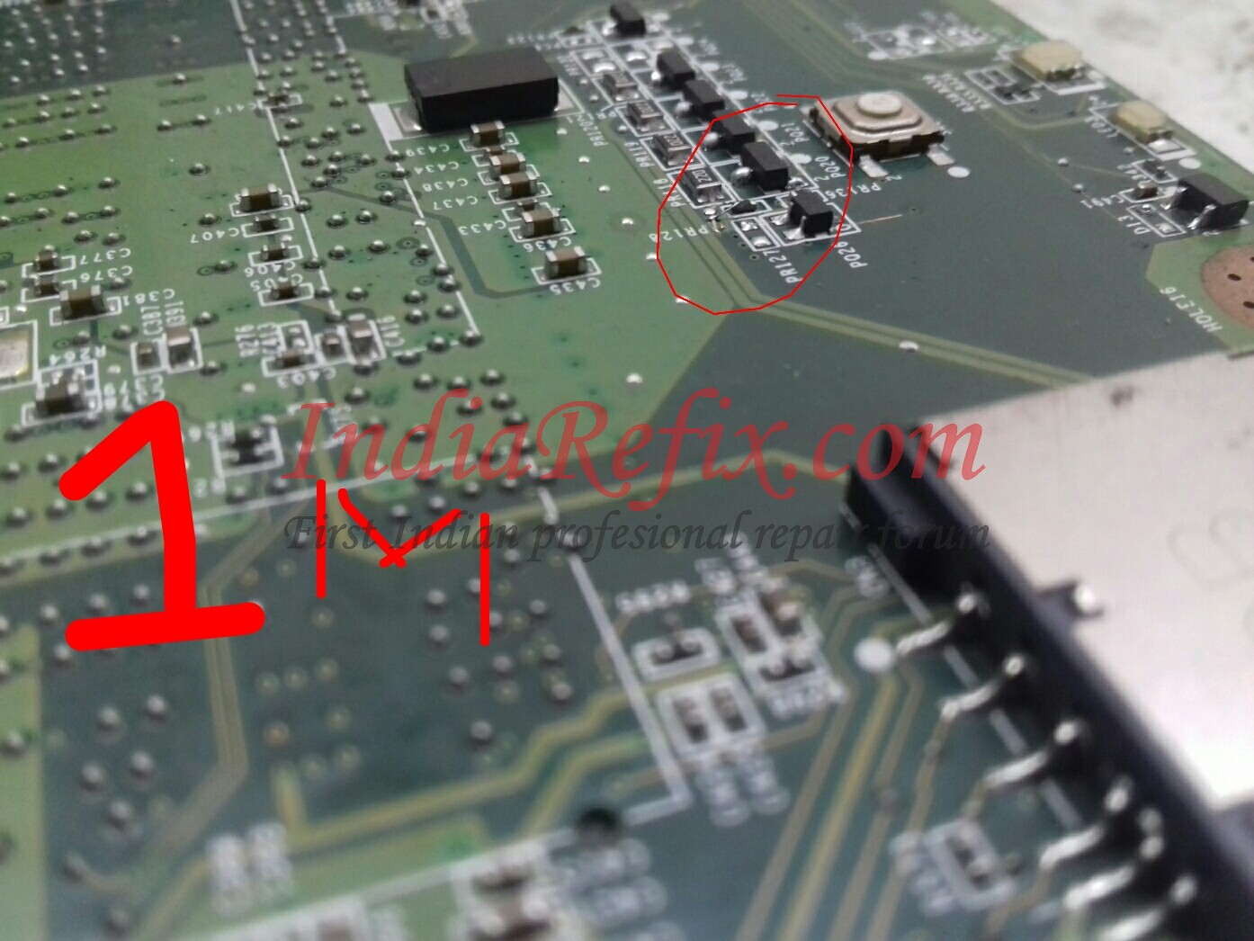

Acer 4739z Dead condition. Some resistor damaged in one side...after make a track laptop pwr on and display also ok...but fan run in any time...after changne 1m resitor laptop pwr on in normal condition.
