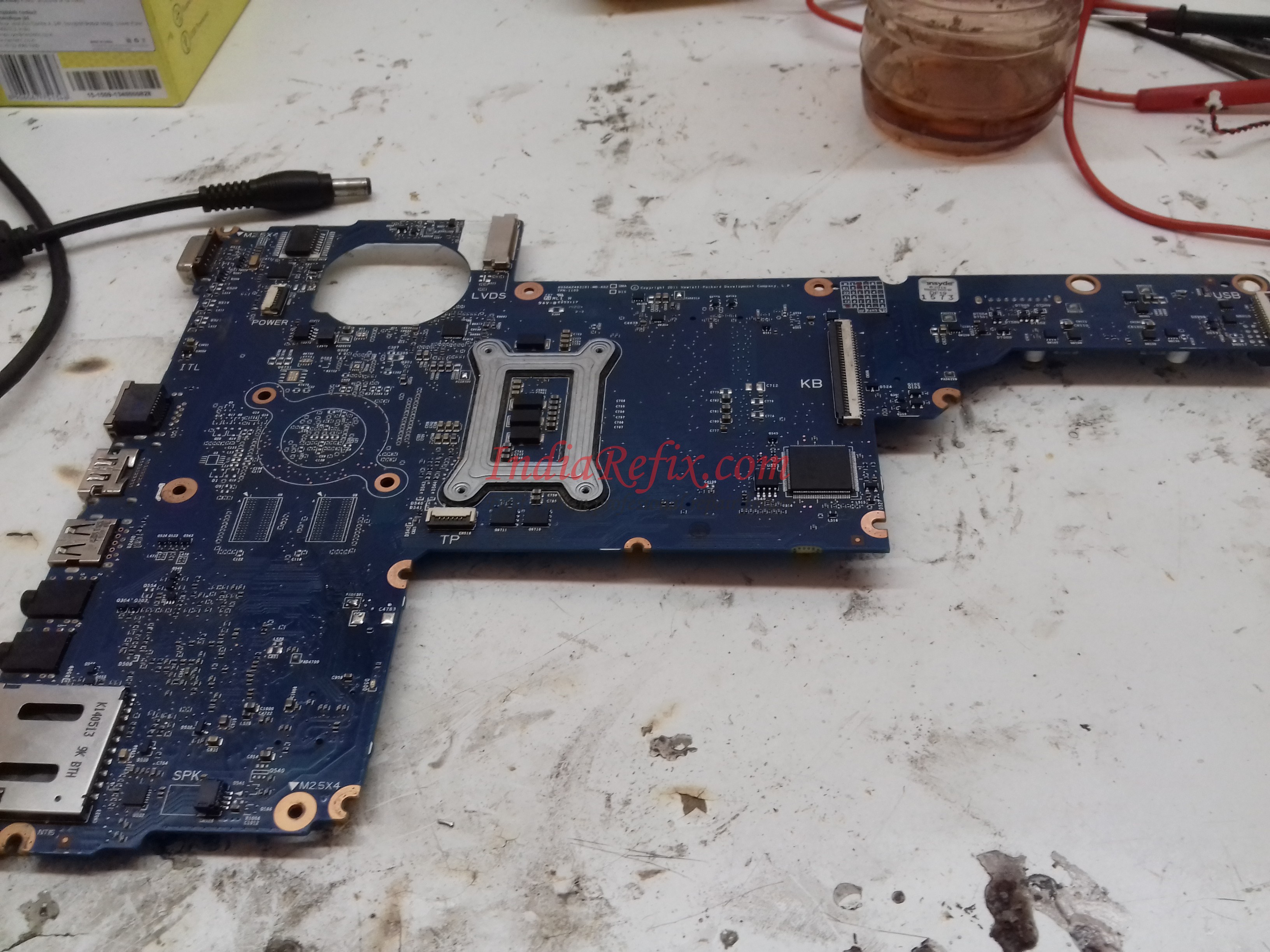

HP 246 NOT CHARGING
Post by MANIKANDAN »
HP 246 BATTERY NOT CHARGING....AFTER REPLACE Q6010 NEAR USB STRIP CONNECTOR...BATTERY CHARGING INDICATION OK...
