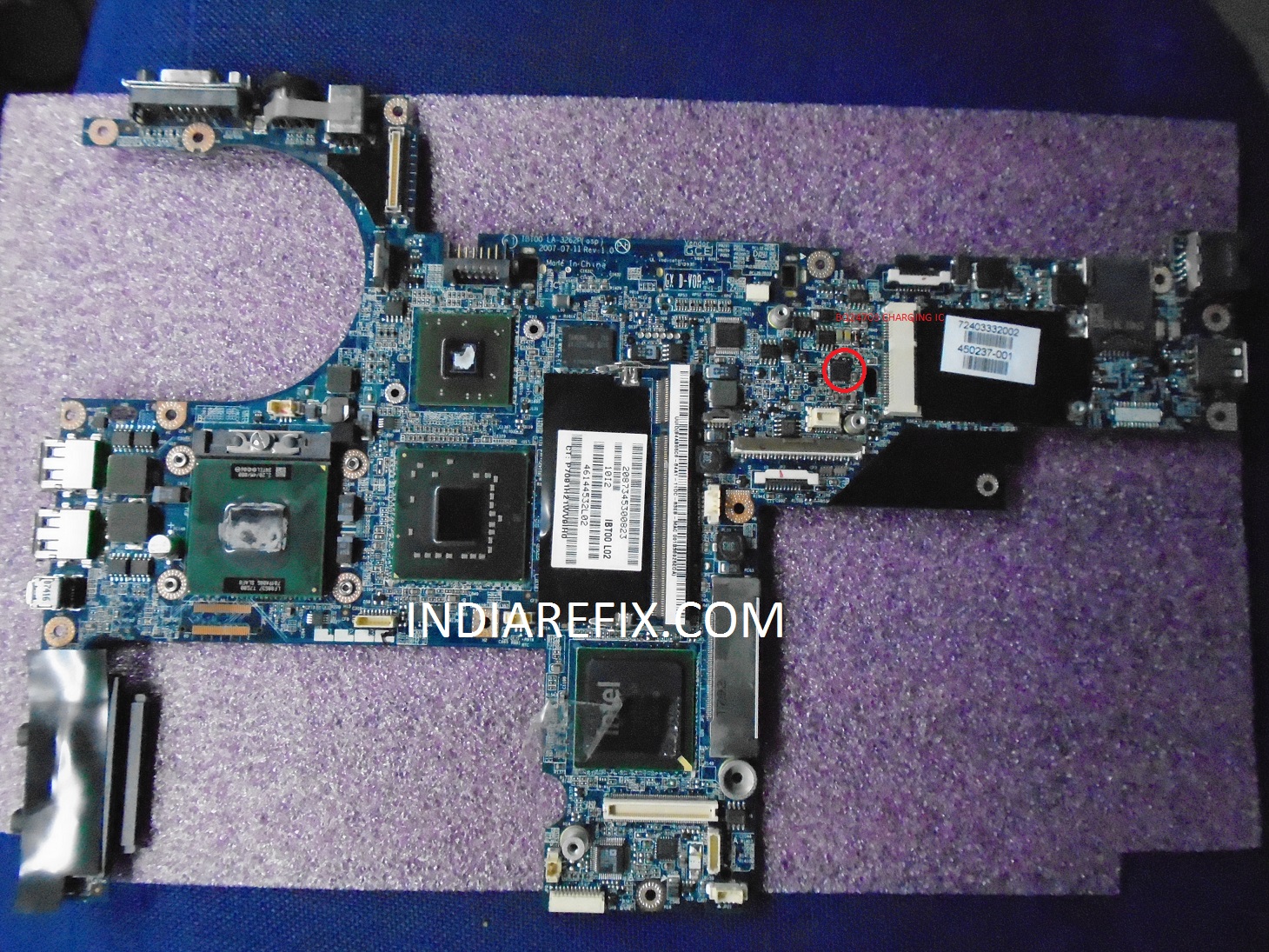

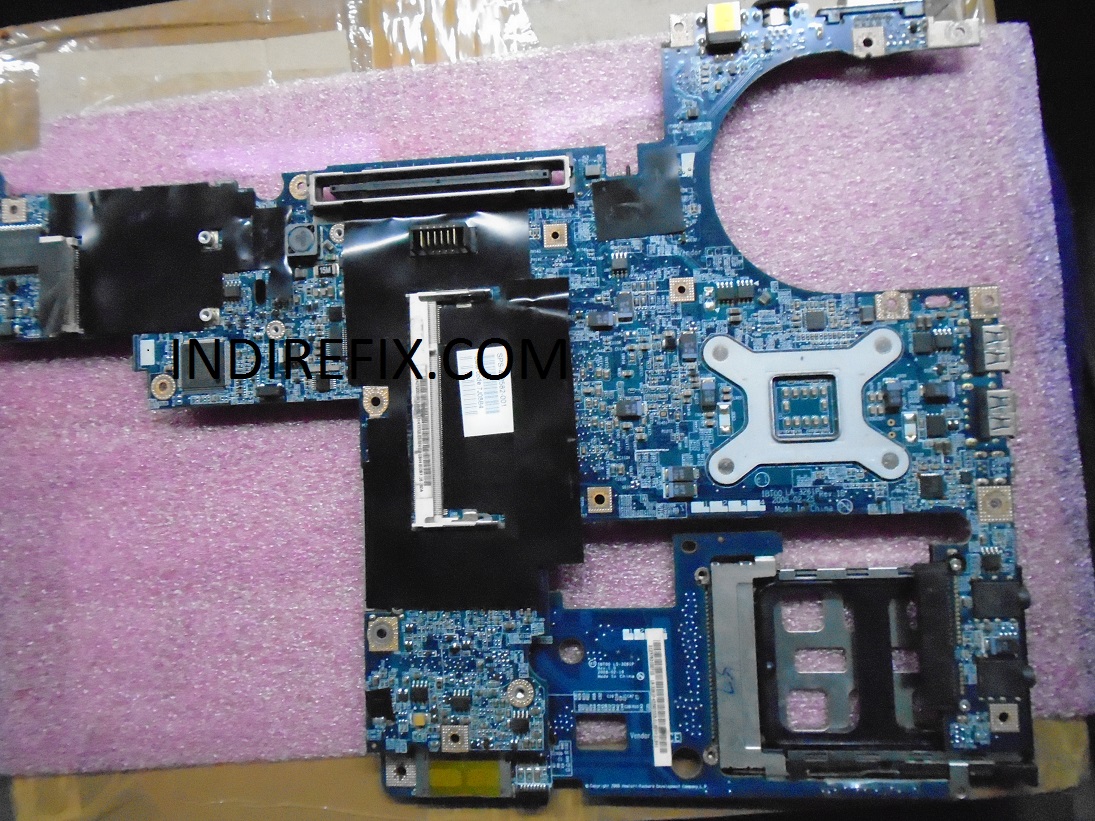

Make/Model- HP COMPAQ 6910P
Motherboard Part No- IBT00 LA-3262P Rev-1.0
Processor Type-Core2Duo-T7500
Ram Type –DDR2
Problem –Charging problem (Plugged in Charging Massage )
Diagnosis- Charging connector +ve over voltage and Charging IC faulty
Process-
Found Charging connector +ve over voltage +15.2V Without battery and other voltage ok changing charging ic PU2(BQ24703) after change charging ic found Battery connector +ve voltage +.5 its ok Voltage then check Charging Is Ok Motherboard Ok
