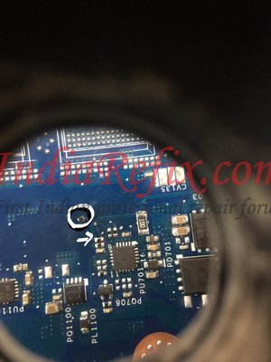

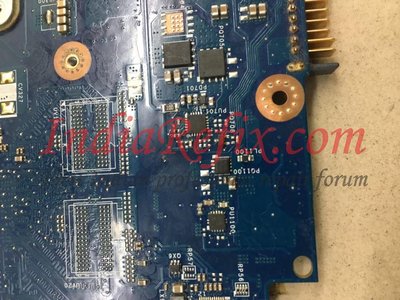

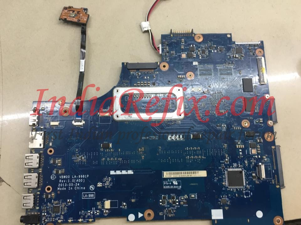

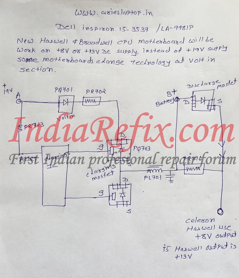

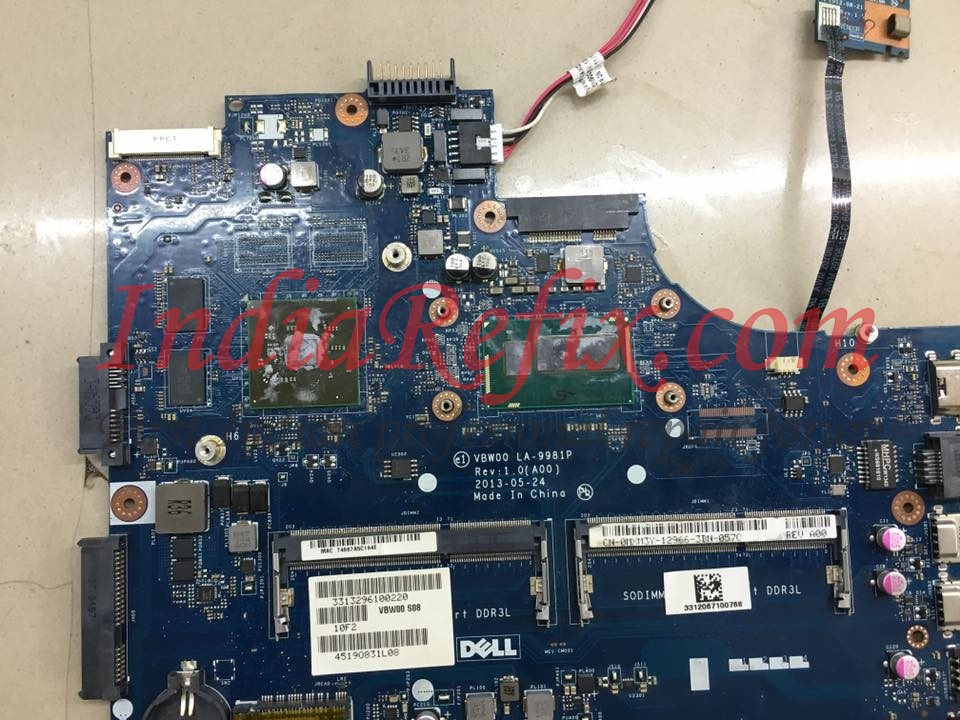

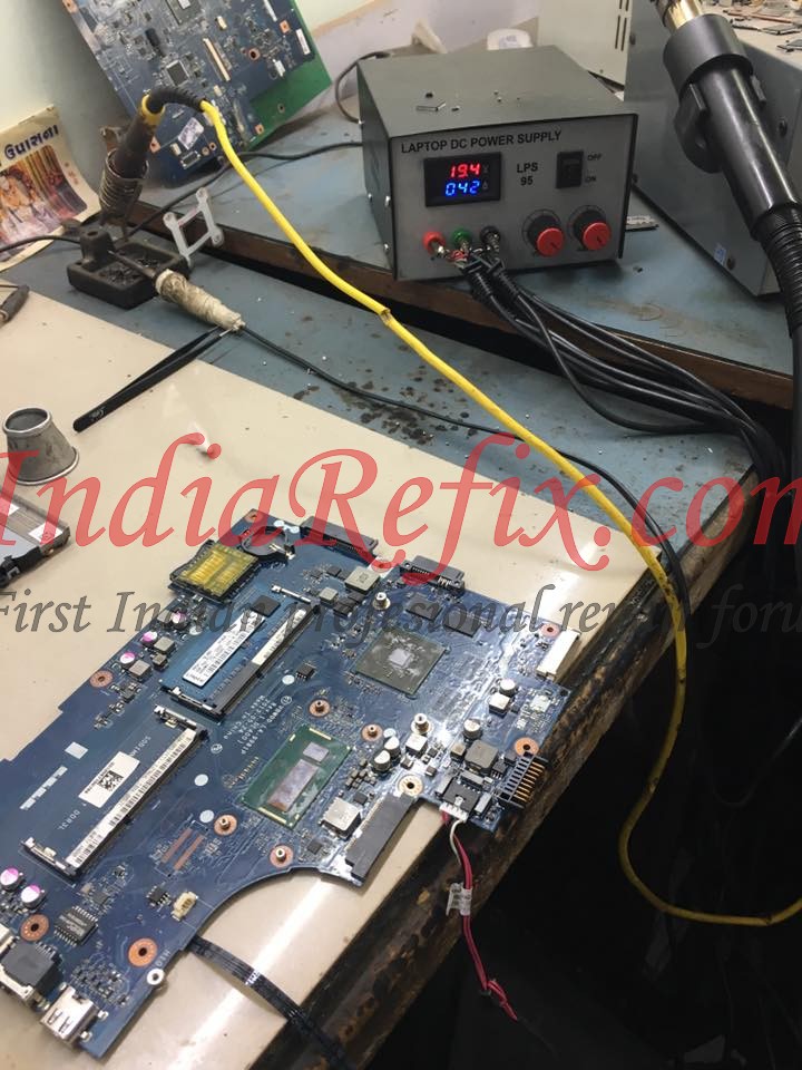

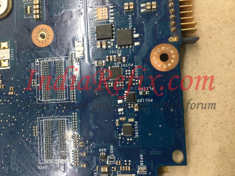

Dell 15 3537 volt in section output off

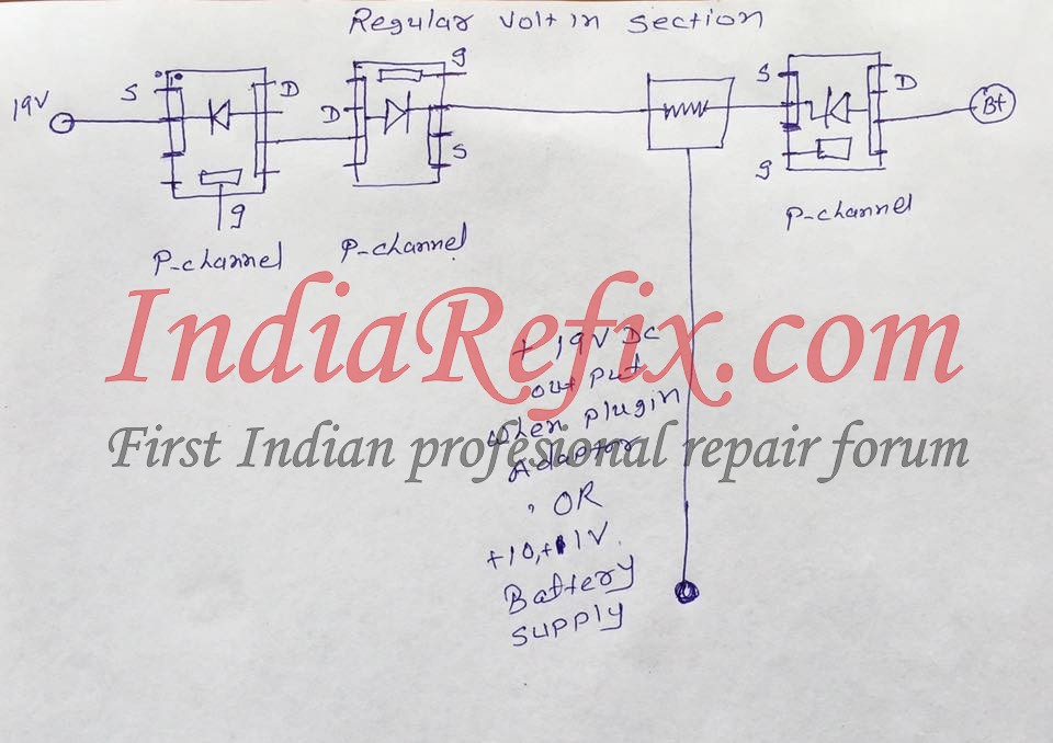

Solution: some haswell new technology use 13v dc supply

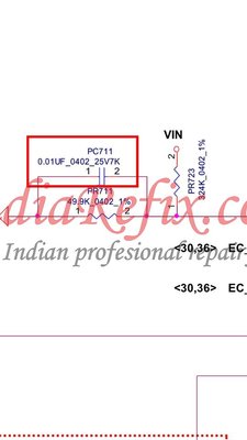

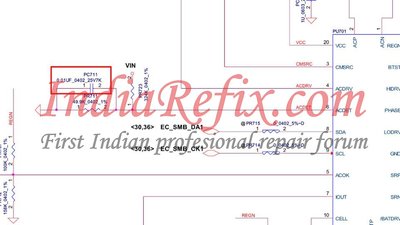

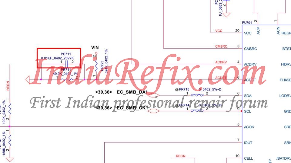

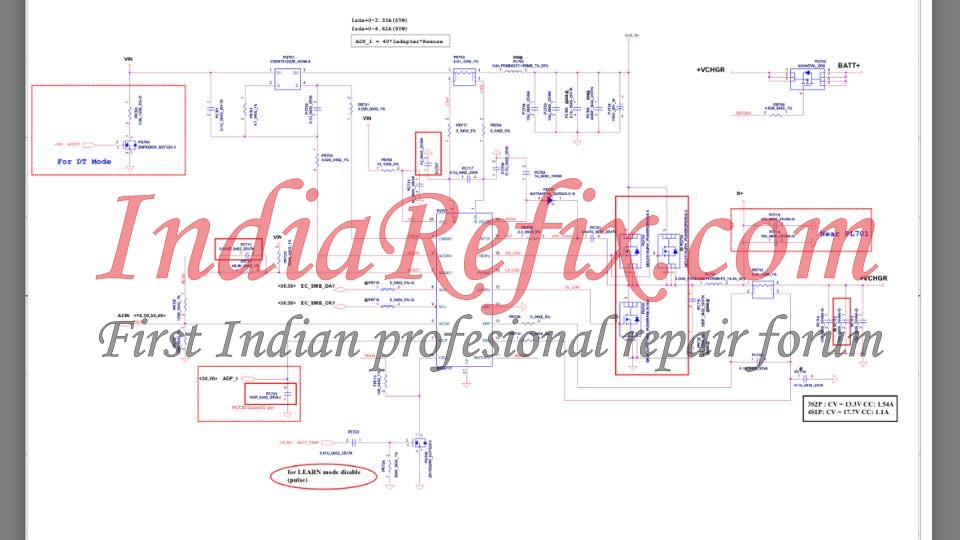

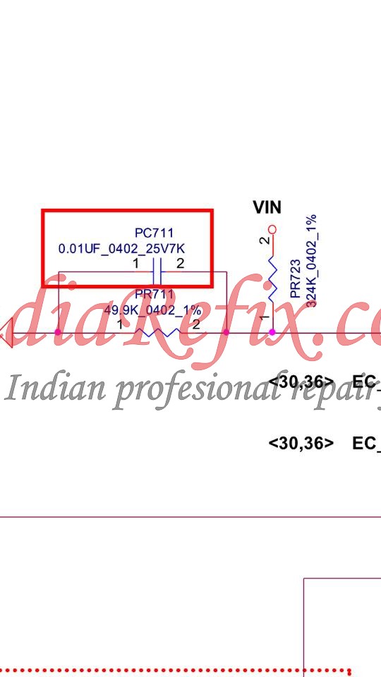

So when i check charging cum output section there is no output for all system VRM

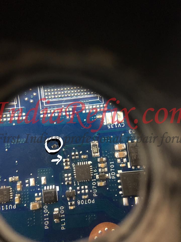

charging ic pin no 6 ACDET volt missing
Pr723 found open and change it . And Volt out start
