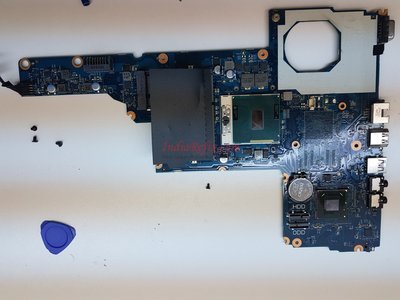

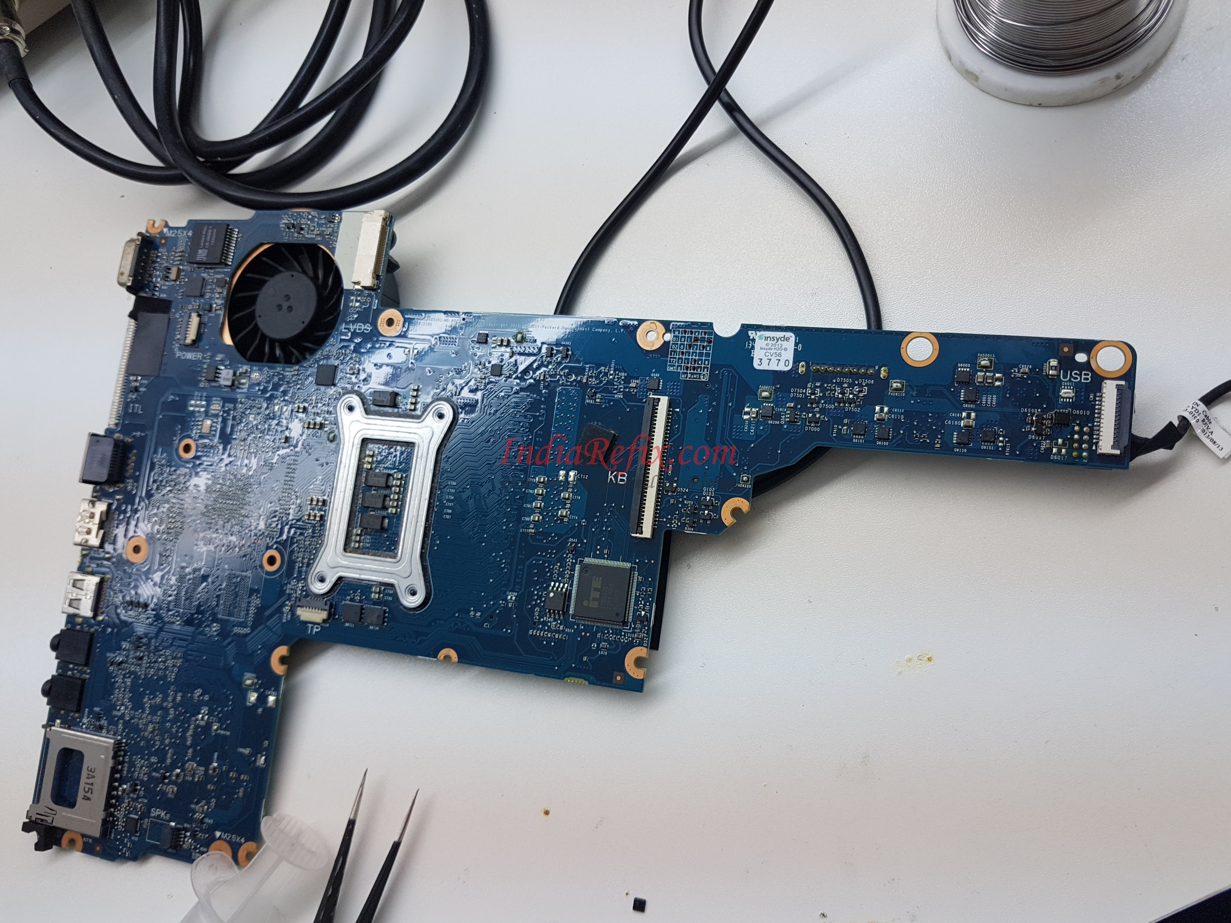

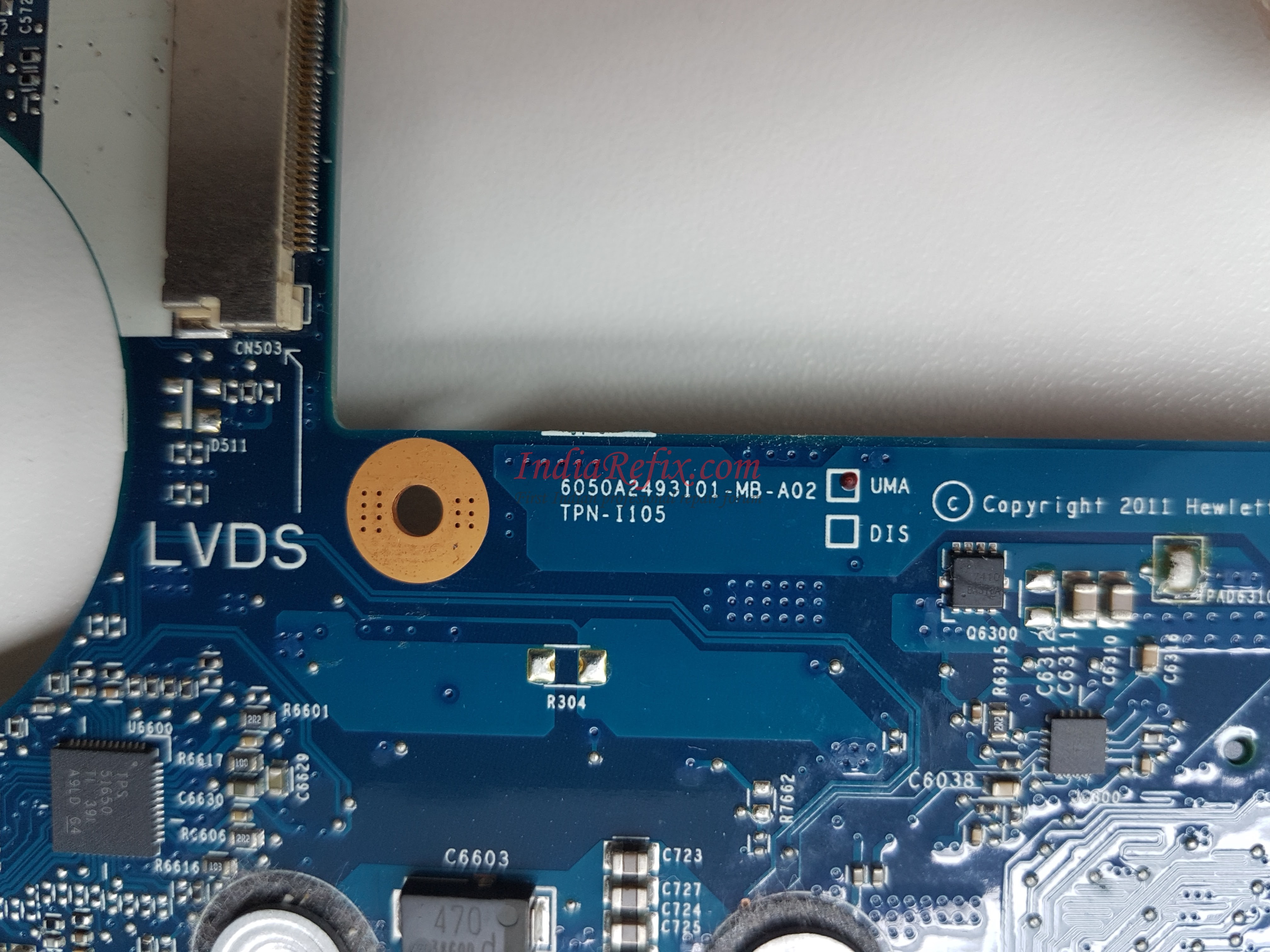

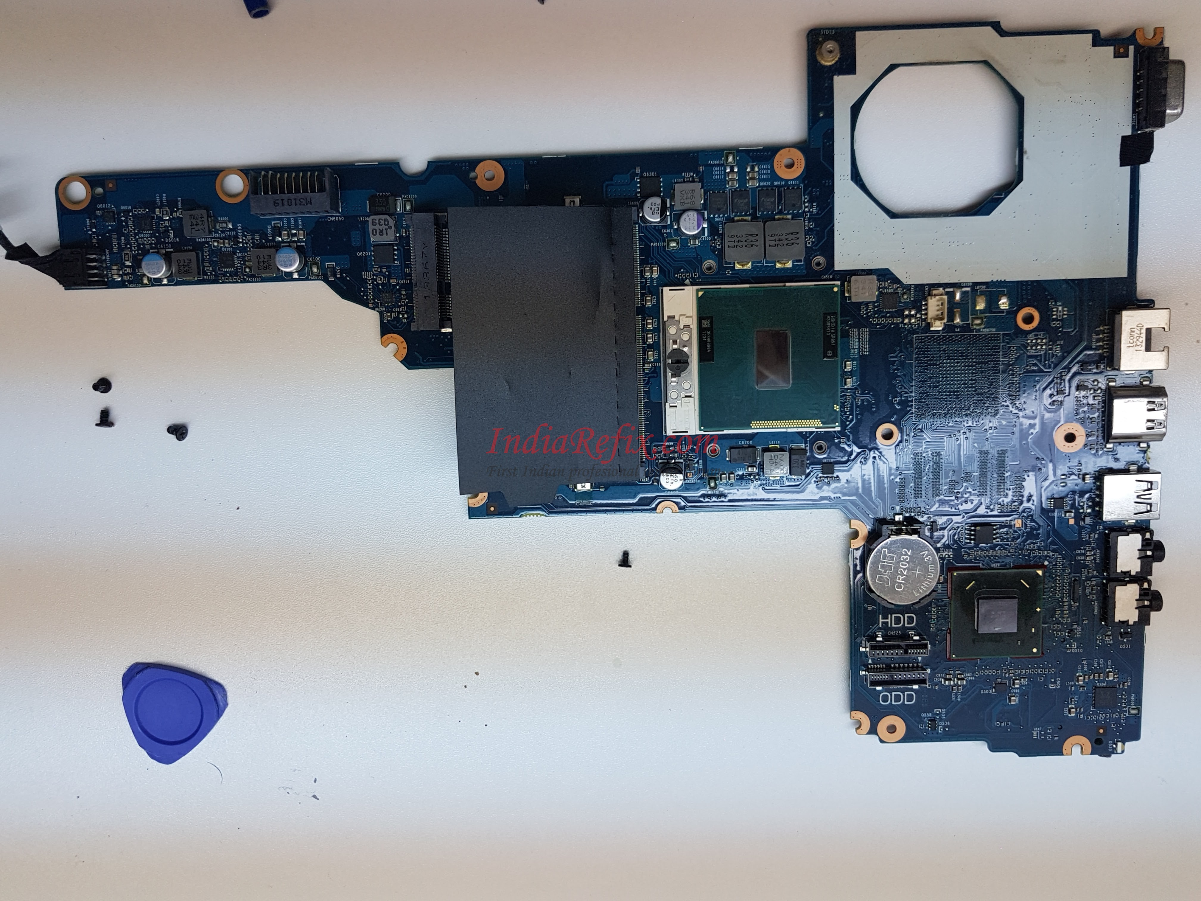

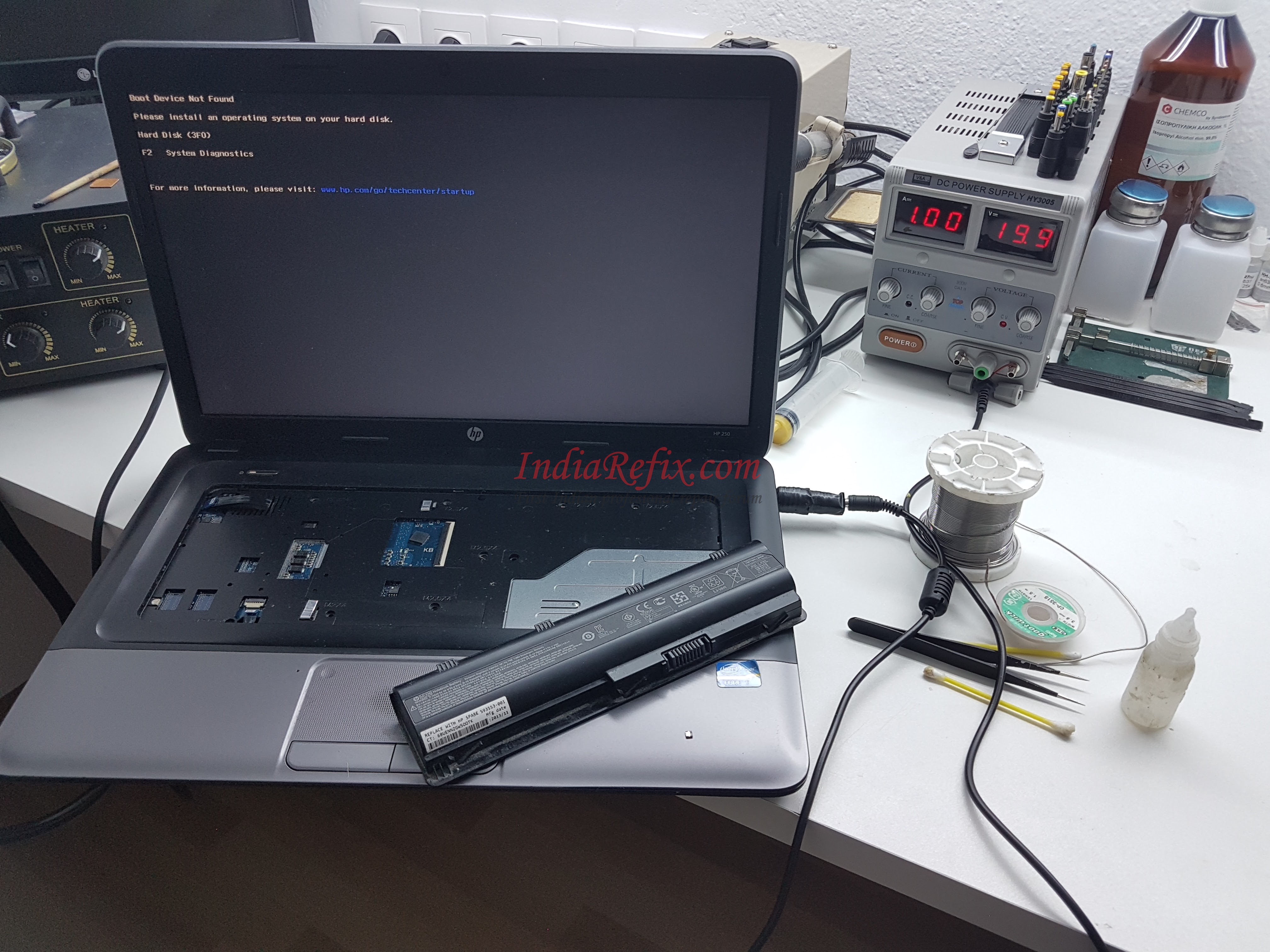

HP 250-G1
PART NO: 6050A2493101-MB-A02
CASE STUDY: DEAD MOTHERBOARD
AMP. 00.0

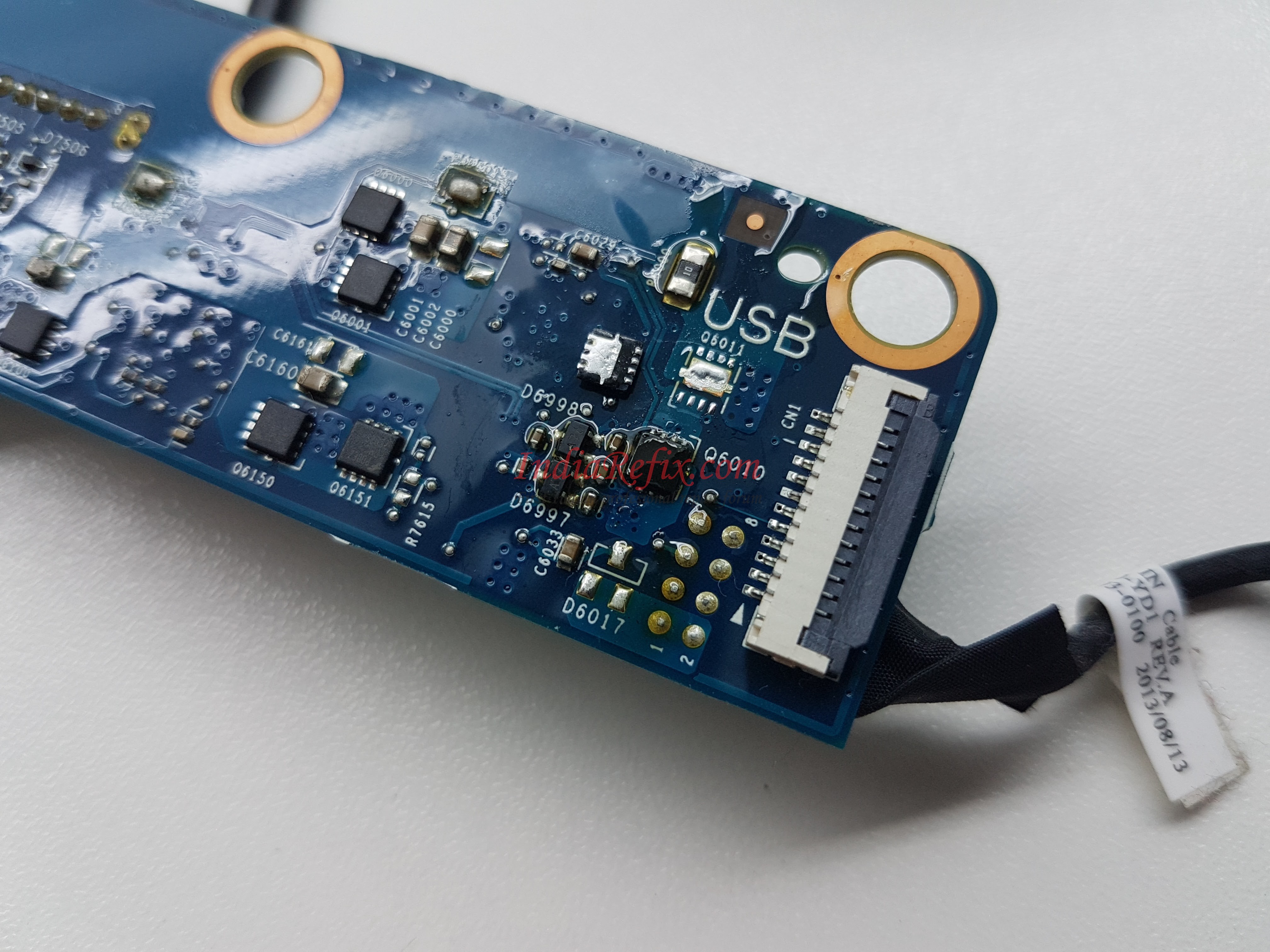

I find Q6010 (AON7410 N-Channel MOSFET) SHORT, I change it and short disappeared.. AMP. 00.3, POWER ON AMP 1.00
