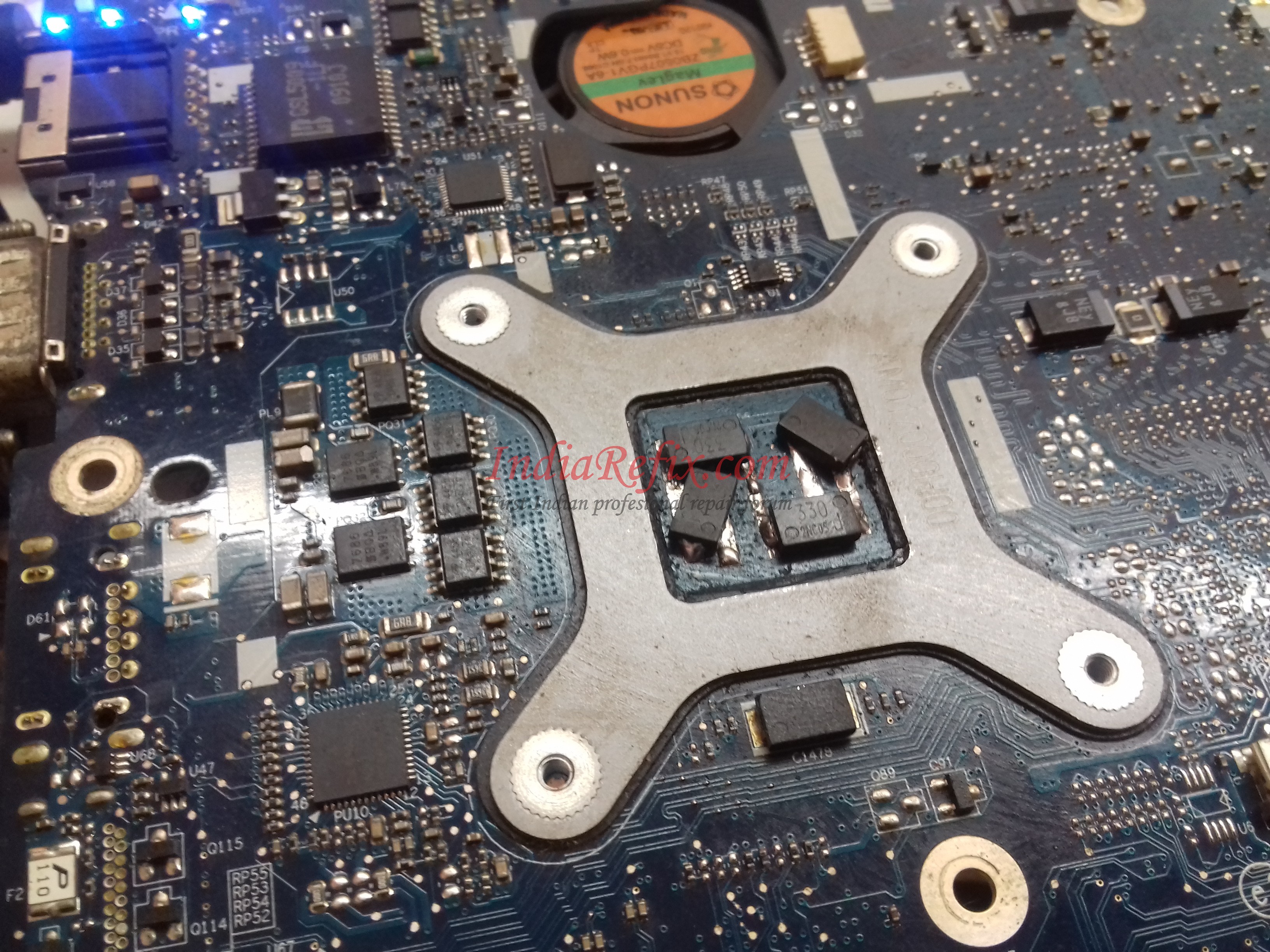

TOSHIBA L300 RESTARTING CONTINUOUSLY. AFTER REMOVING NEC TOKIN ARRANGE 4CAPS LAPTOP WORKING FINE.

expain in detail please what is nec tokin.?

Nec token is High frequency Capacitor which suppose to change with normal tantalum capacitors

can you share any pic of it..??
MANIKANDAN
