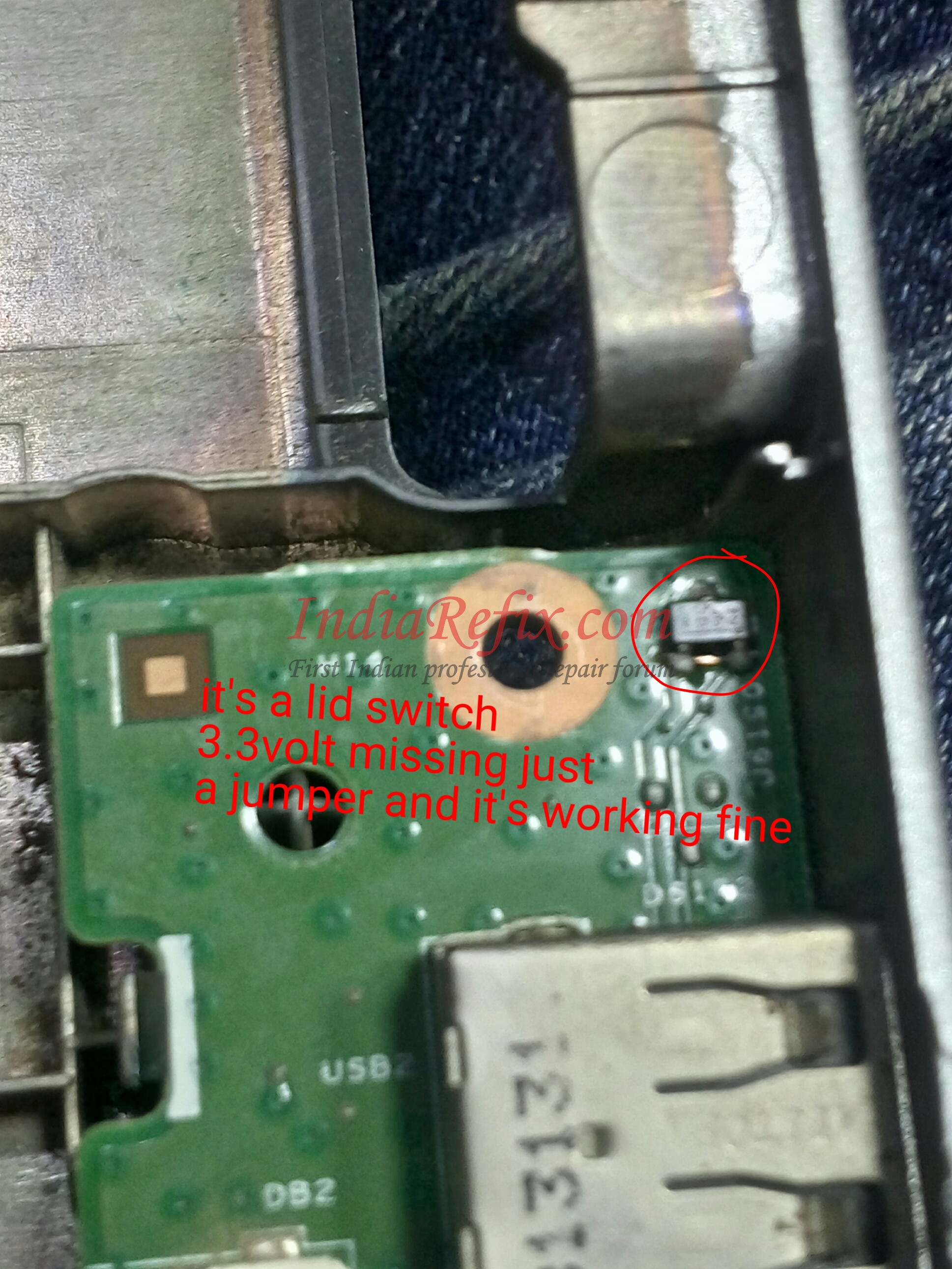

Dell vostro 2520 dim display
Found lid switch 3.3 volt one side missing just make a jumper and job done
It's working fine now thanks to indiarefix
