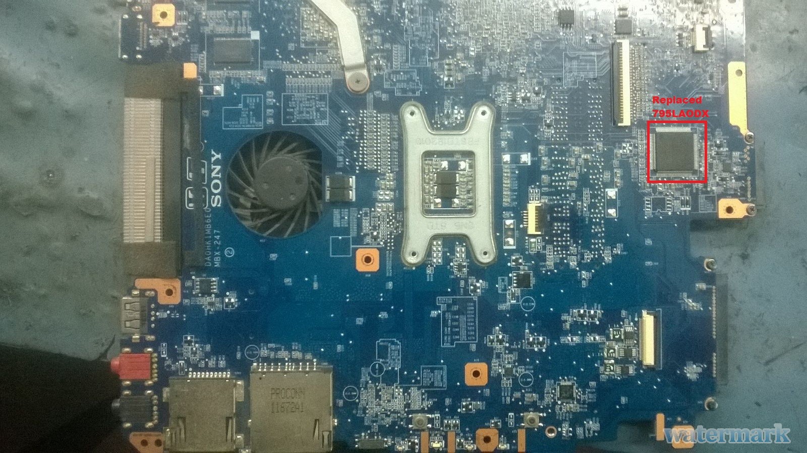

Laptop : sony
Model : MBX-247 (with graphics)
Problem No display
Diagnosis: I/O Controller faulty
motherboard power on but no display ...psu consumes up to 1.1 amps .....
all voltages ok ....suspected i/o replaced and job done ...
here is pic
Re: Case Study MBx-247
but sir what is the connection between i/o to display...
sir you said all voltage were ok
but why you change i/o

How did u find that IO is suspected????

sie all voltage is ok but laptop not power on

how it posible ? without power on all supply ok ???????????

Sir io se kaun sa signal nahi nikal raha tha jo app ne io change kiya
