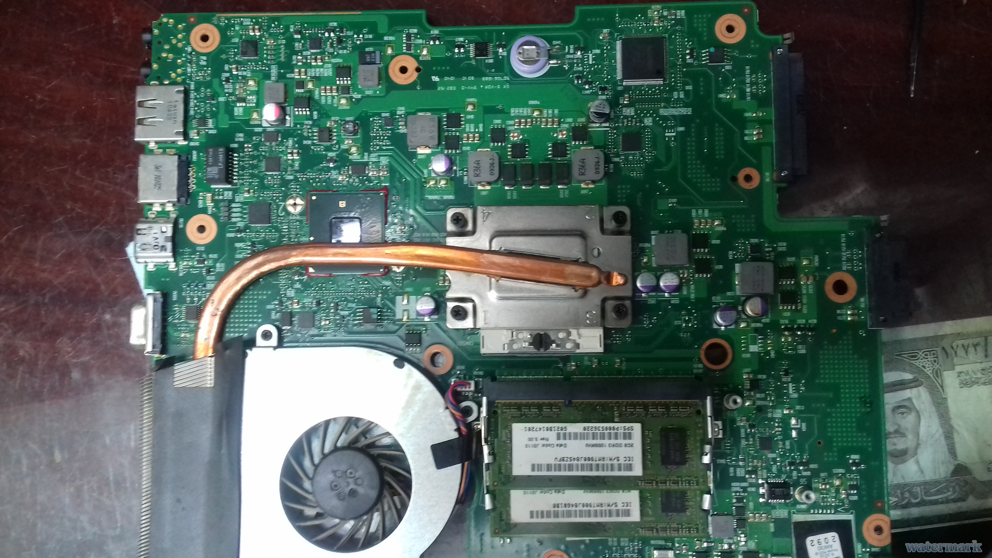

Tosshiba satellite L650-1PD
PART NO: PSK1EE-0D600TAR
M/B NO: 6050A2332402-MB-A02-TI
Hai.....getting only white screen..
change screen...cable..Q3000....HOW TO SOLVE THIS ISSUE...

check lcd_vdd

SOLVE THIS ISSUE FOR CHANGE CONNECTOR....

according to schematic first lcd-vdd
