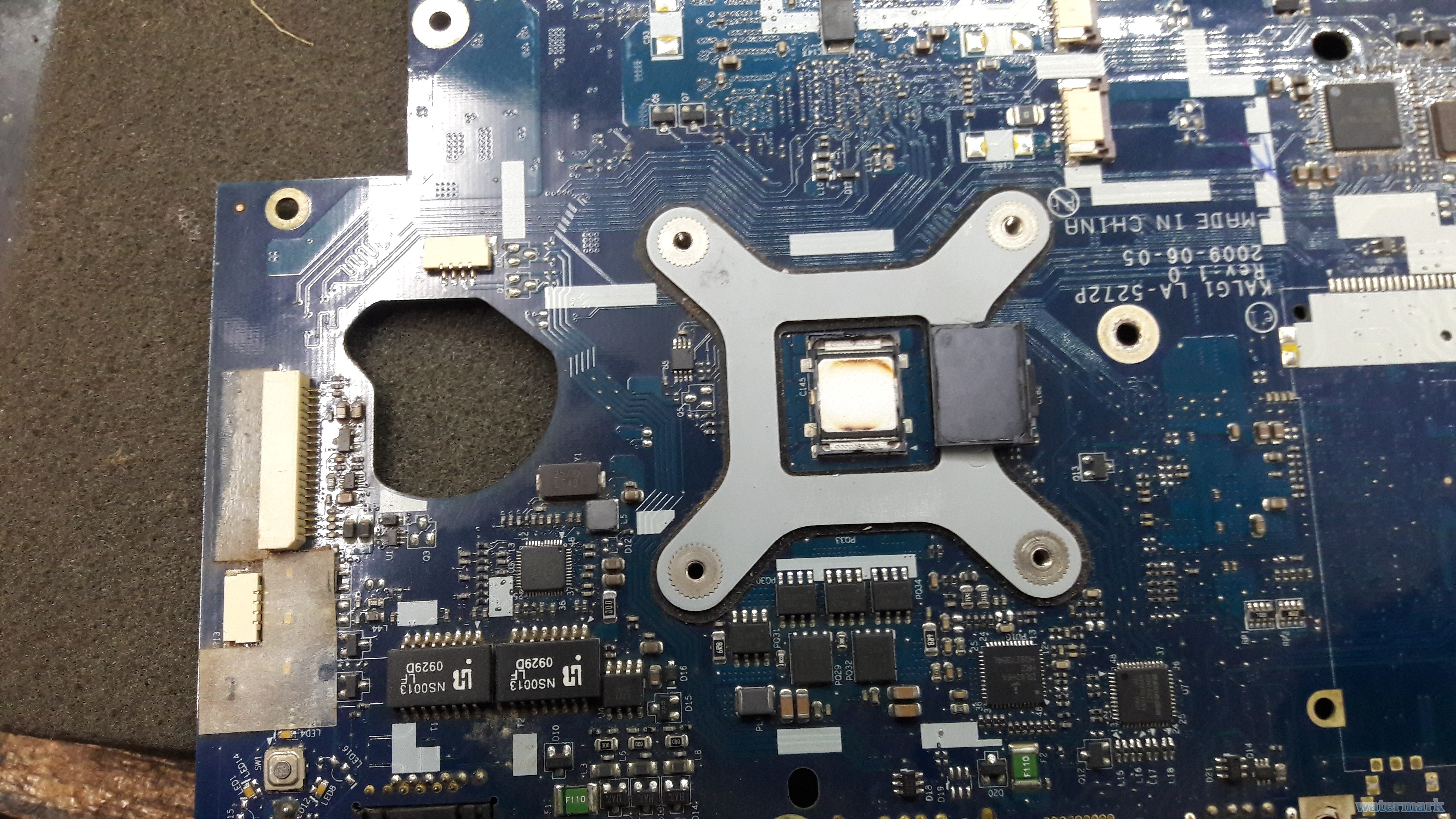

Remove cover of NEC Token then You can see in attached snap of NEC Token capacitor brownish border ..or burning signs
If this is found then NEC Token need to be replace
Way to veryfy NEC Token capacitor ( Author: Swanand)
