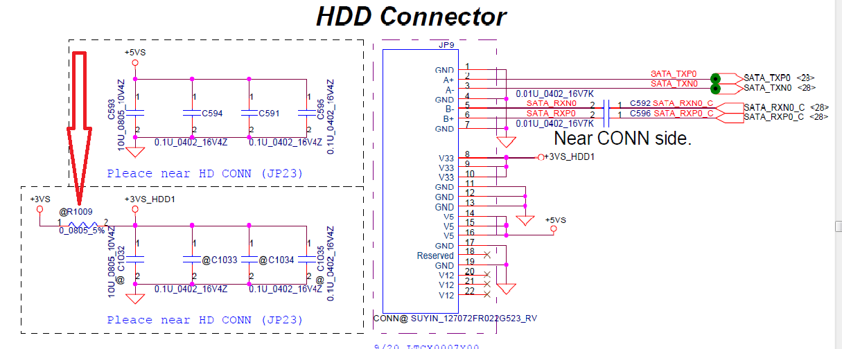

i hav checked
hdd connector
no 3v on hdd pin connector. im trace the power where miss +3vs
pin 8-10 should be 3v. but no volt
pin 14-16 got 5v.
I found (R1009) resistor is burnd then replaced work done HDD is working fine on this laptap
