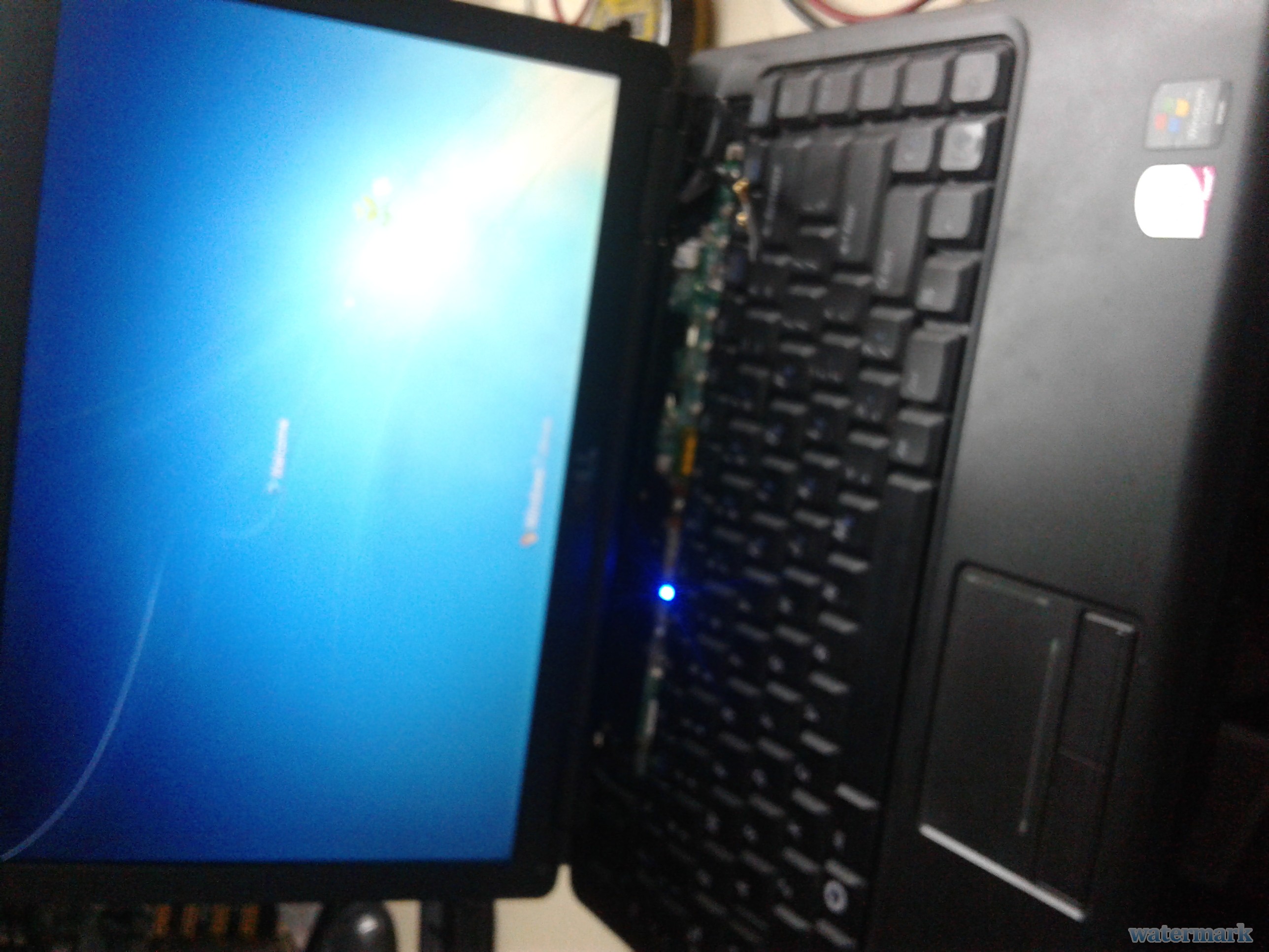

Post by hny »
Dell vostro 1400 no sound customer said last time repair technician declared its sound chip or ICH fault.. the problem is after install os win 7 ultimate speaker sound not coming but headphone sound ok i chk all volt ok google say its cimmon problem in this model try driver install sigmatel audio driver and sound ok :D sory for bad english
