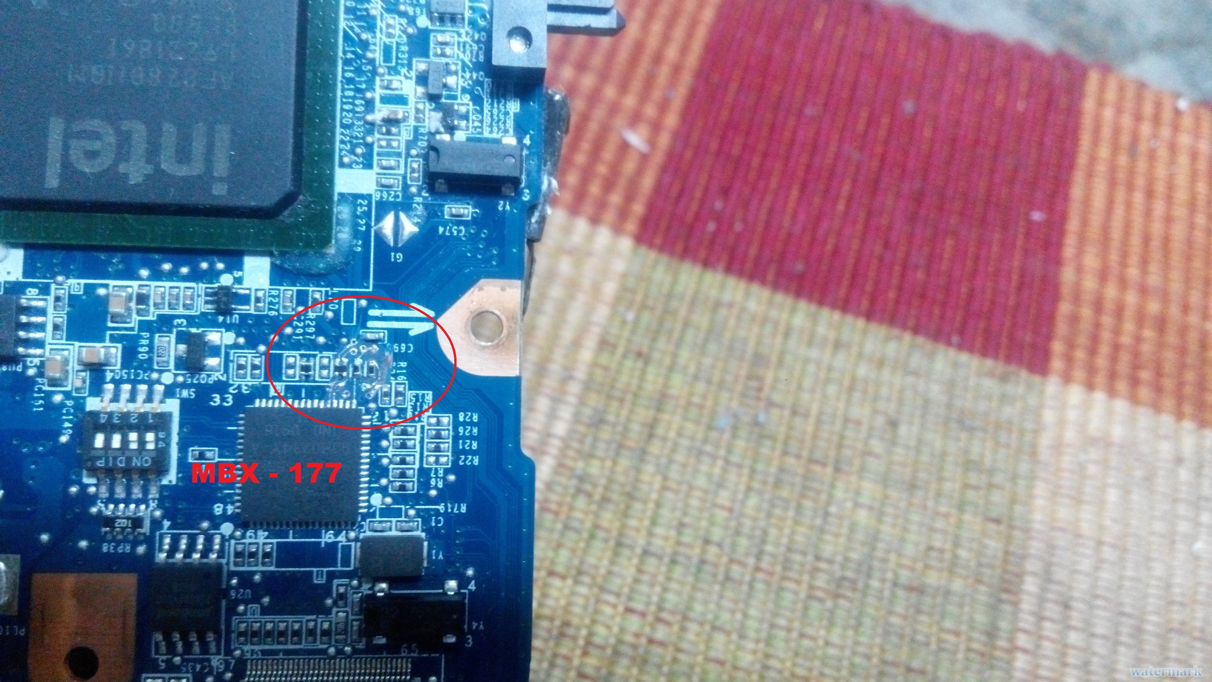

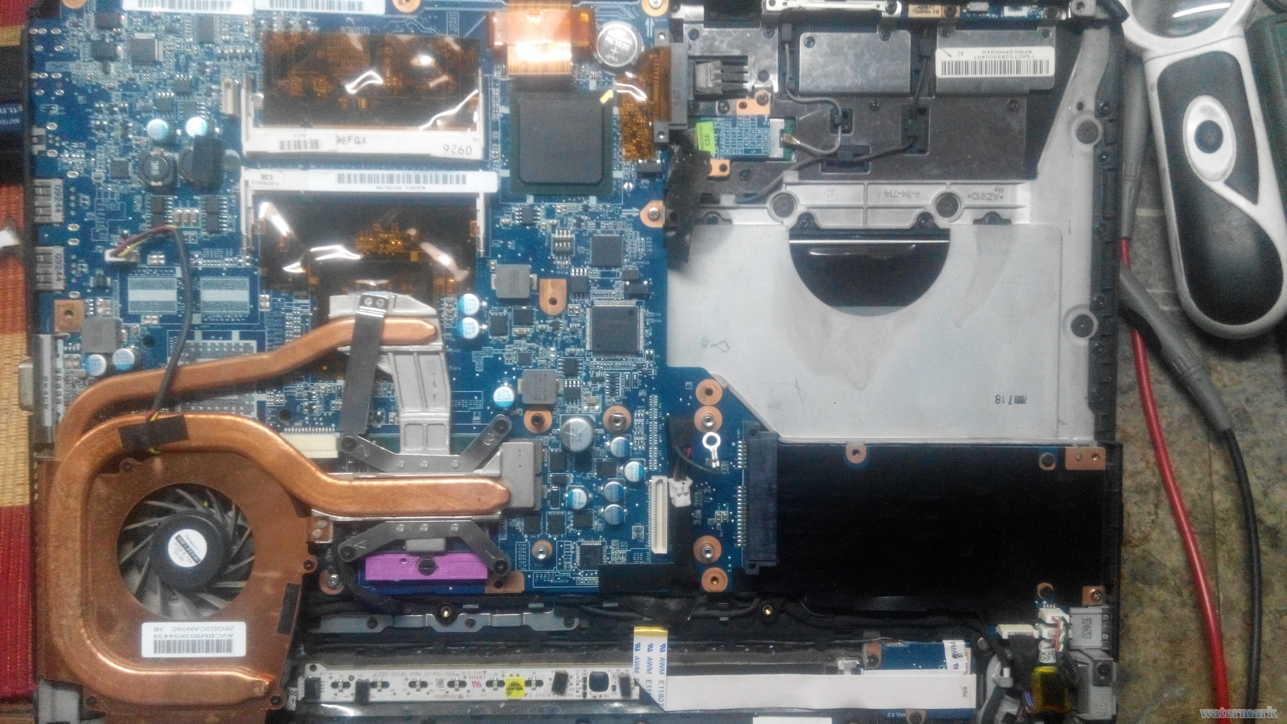

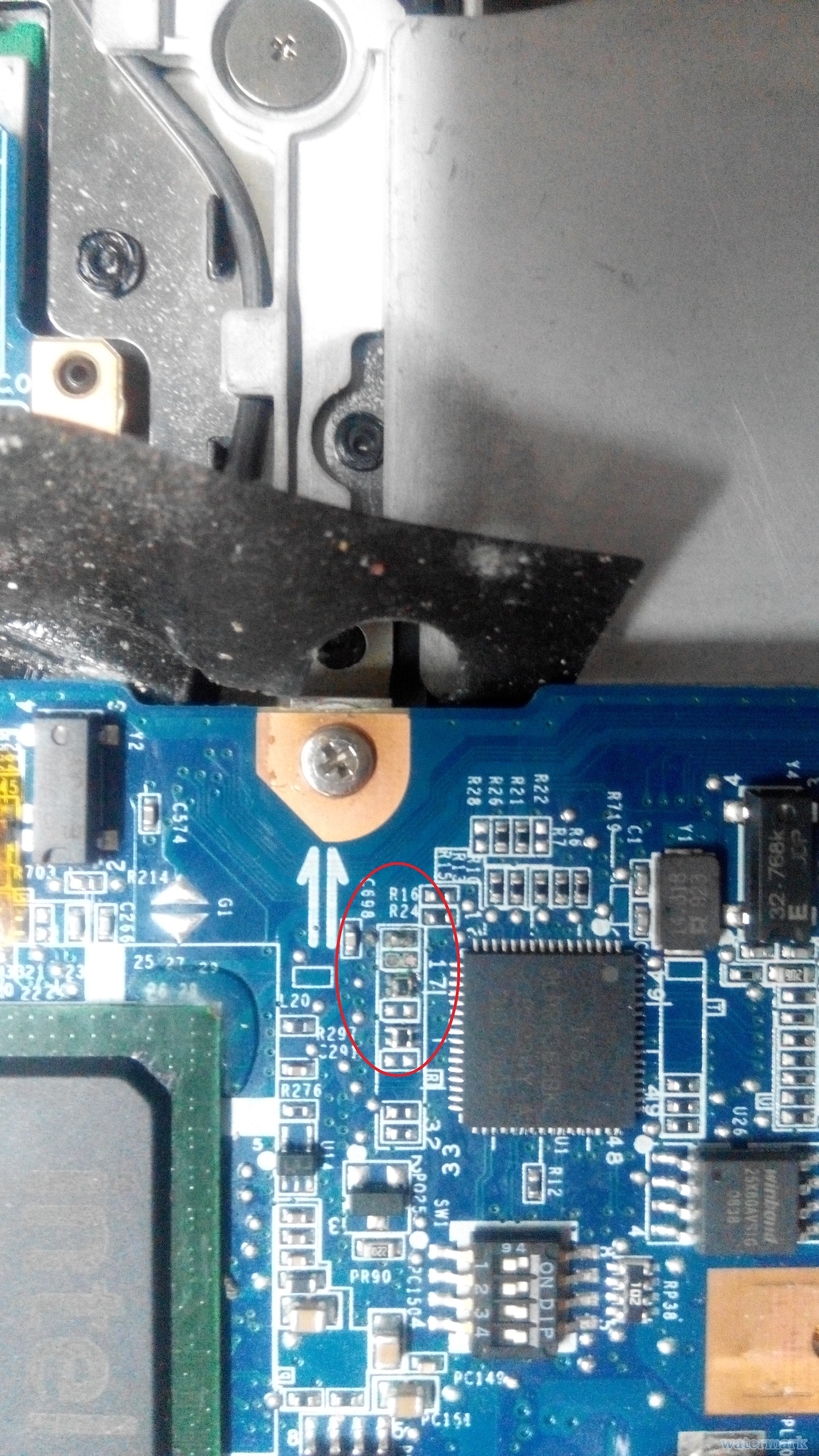

Case Study : Sony Vaio VGN CR220
Pcb no. : MBX-177
Fault : some time display .
Diagnose problem near clock ic some resistance not working properly due to rusting . R_DREFSSCLK RP6- 22 ohms pack, CPUBSEL0 R8- 2.2K , R_DREFSSCLK R2 - 22omhs. After change laptop working fine.
