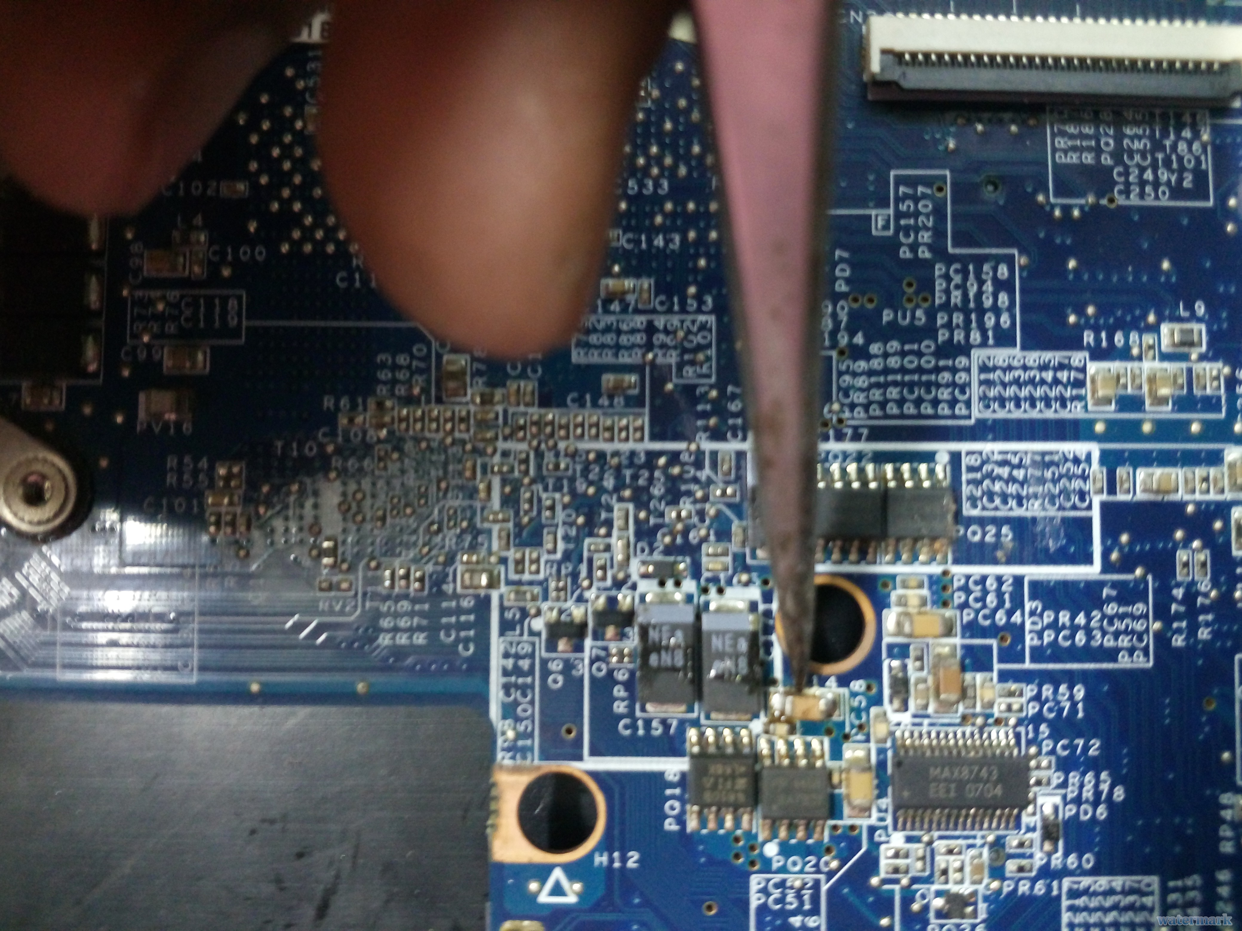

THE LAPTOP WAS DEAD +19 VOLT WAS MISSING
PC58 CAP (SEE IN IMAGE )WAS SHORT, JUST REPLACE IT
NOW LAPPY IS WORKING FINE
