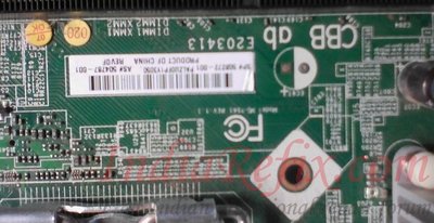

model - hp board (ms-7561 rev1.0) msi
i/o- w83627dhg
problem- no power on

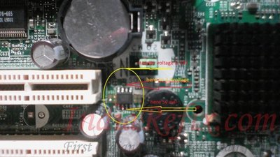

checked in i/o pin-61 no voltage ( here need 3.3v stand by for i/o internal logic on)
checked in pin-72 ps on voltage avilable 5v
checked in pin-74 vbat no voltage (here needed 3.3v which is coming from cmos batt)
solution
change the cmos battry also not voltage avil in pin 74 , so trace it found junk in cmos jumpeer, brush it and voltage
avil in pin-74
then checked for stand by voltage in board found u31 is the stand by voltage regulator (ic up7706) but here only
5v no 3.3v
so change this ic and 3.3v is generate and found 3.3v stand by in i/o pin-61 , also voltage coming to on /of panel

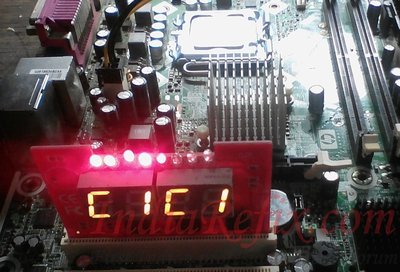

now board power on but no display
debug show reset high with 0000 code
change the i/o w83627dhg-a version and power on and display coming
now its done working fine
NOW BOARD OK CODE C1 C1 WITH OUT MEMORY
ic up7706 and details voltage needed

msi board ms 7561
msi board ms 7561
