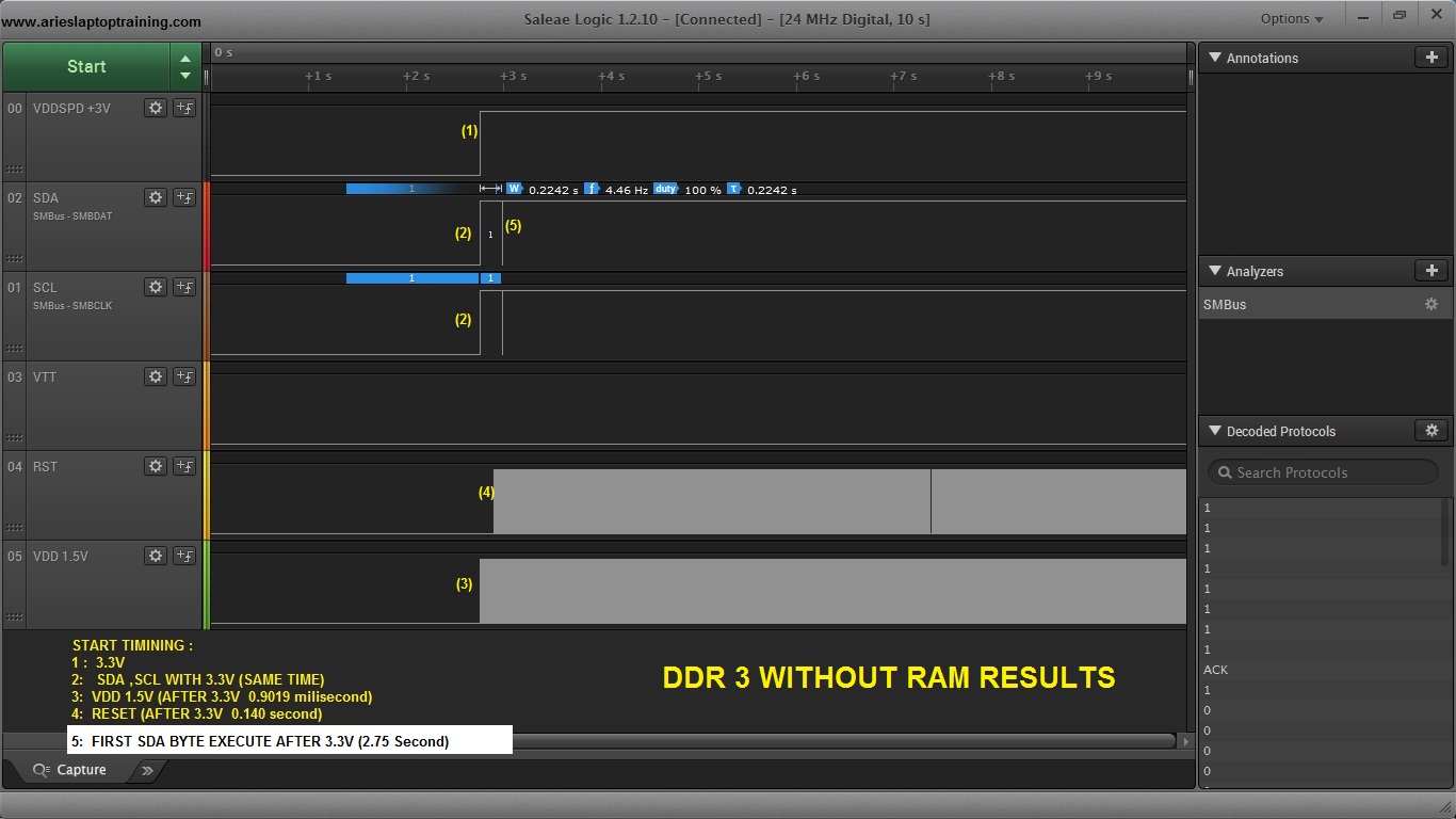

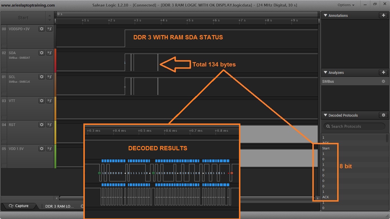

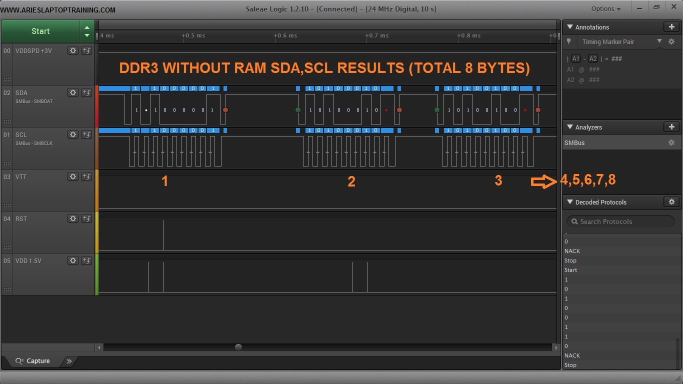

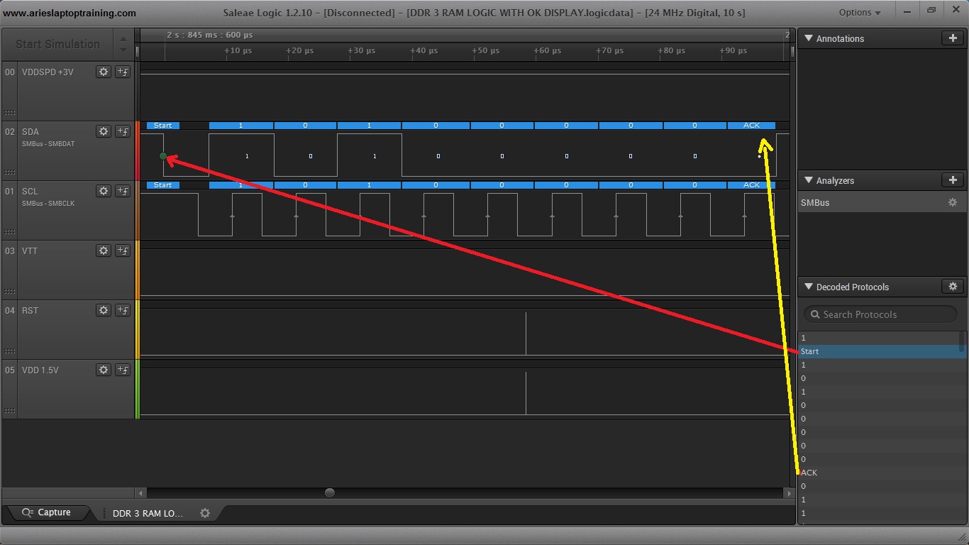

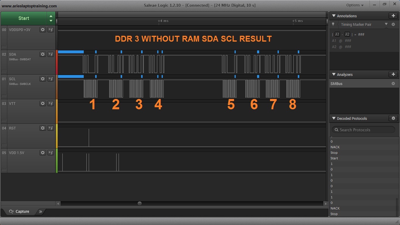

Here attached some sda ,scl results with ram and without ram as per arun sir described in video
