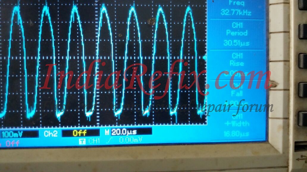

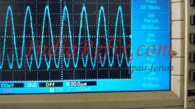

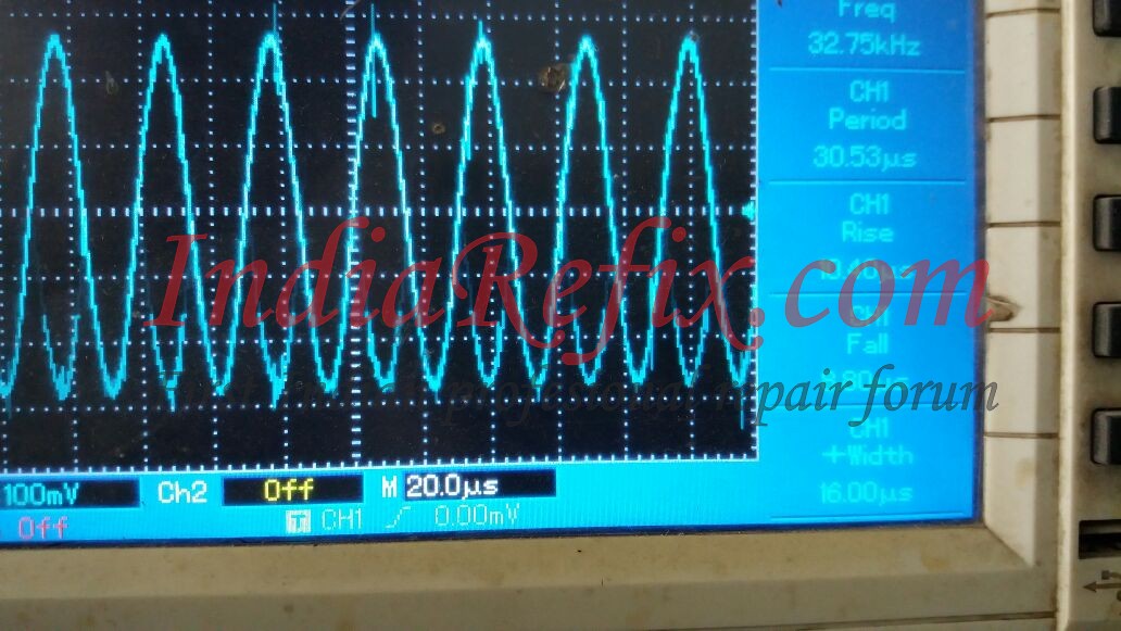

3.       RTCX1 and RTCX2.      Basicaly ICH/PCH uses a internal timer IC having 256 byte of RAM which keeps track on date, time and system settings.  Ich/pch uses a cristal circuit to genrate a low swing sine wave of 32.768Khz at RTCX1 pin as input to the internal oscillator, and this input signal is amplified and driven back to the cristal circuit through RTCX2 pin of ICH/PCH with the same frequancy of 32.768 Khz but with littel higher amplitude due to amplification . thats why when we check the cristal pins with multimeater we found little diffrence in voltage at both pins. And it is the first check point whther the oscillator circuit of ICH/PCH is initallised or not .

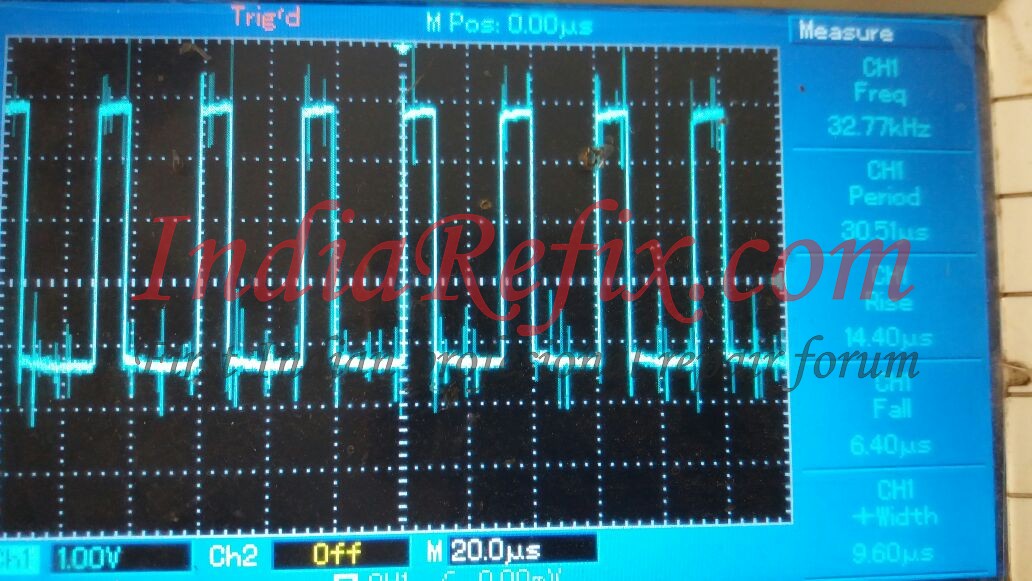

4.       Sus_clock.     The RTCX1 input is amplified for the purpose to drive internal logic of ICH/PCH
And  genrates a free running full swing square wave of same frequancy of 32.768 Khz as
Clock out put for system use . this out put of ICH/PCH is known as SUS_CLOCK.
SUS_CLOCK is the shure short way to check wether the RTC section is working properly or not by checking the wave form.
Thats why we requires the DSO/CRO to check signals at motherboard as  RTCX1, RTCX2 and SUS_CLOCK have the same  frequancy of 32.768 Khz if we check with frequany meater but the diffrence is the wave form (shape of the wave).

Rtc cristal x1 pin .
Pure sine wave of 32khz.
Out put of rtc section to the cristal pin x2 .
Same frequency of 32 khz but diffrence is amplitude . Little high amplitude due to amplification .
Sus_clk output of rtc section . After pressing pwr btn . Full swing squre wave of same 32khz .
