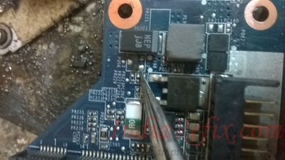

HP CQ42 NOT CLEAR 1V SUPPLY-
THIS TRANSISTR IS SORT SO 28V NOT AVAILEBLE ON GATE PIN OF PQ52.
AFTER CHANG CASE SOLE - 18 V PASS OUT BY PQ52................. :lol: :lol: :lol: :lol: :lol: :lol: :lol: :lol:
Re: hp cq42 18v not clear
Good job
