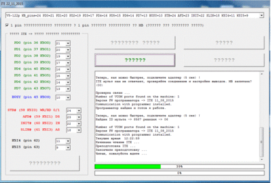

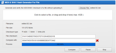

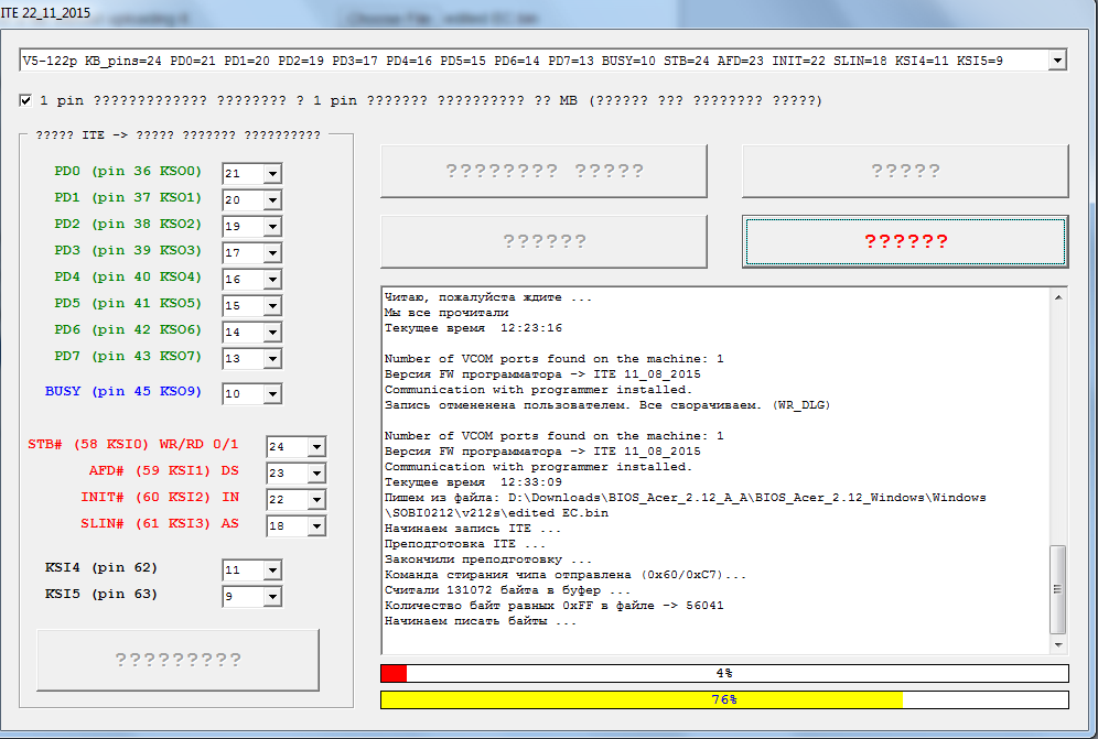

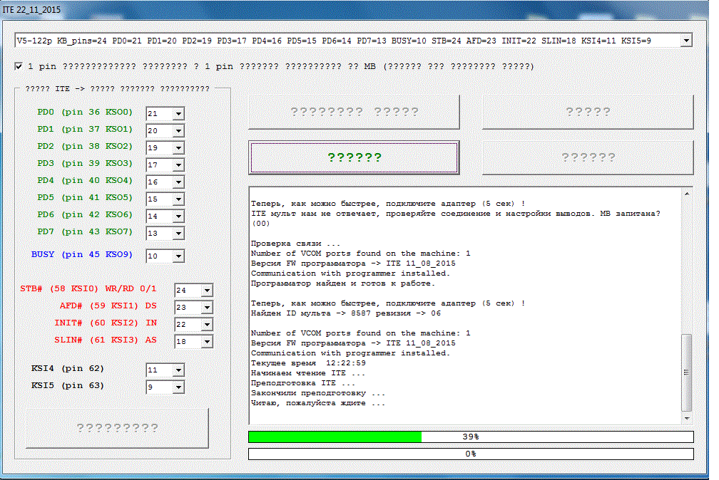

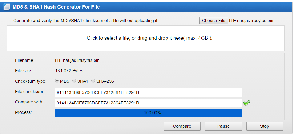

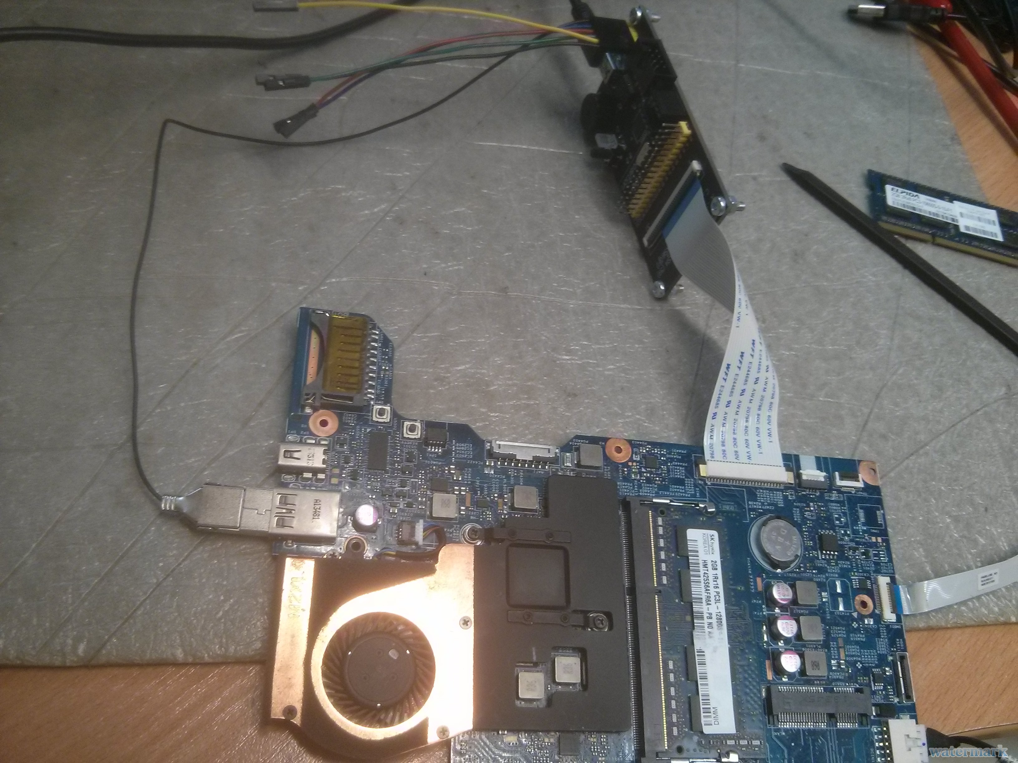

Flashing ITE8587 ( Author DO MAS )
Flashing ITE8587 with sp tool

SIR WHICH SPECIAL TOOL YOU HAVE USED? PLEASE GIVE DETAILS......

Svod programmer
