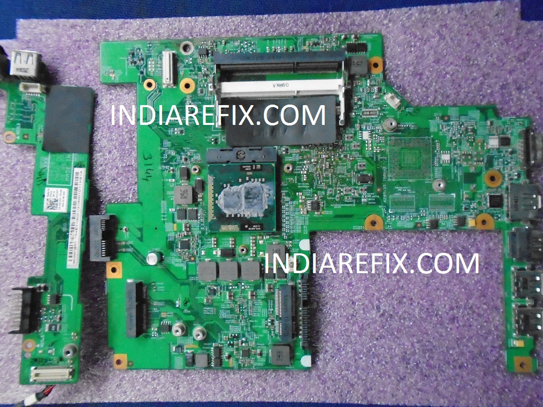

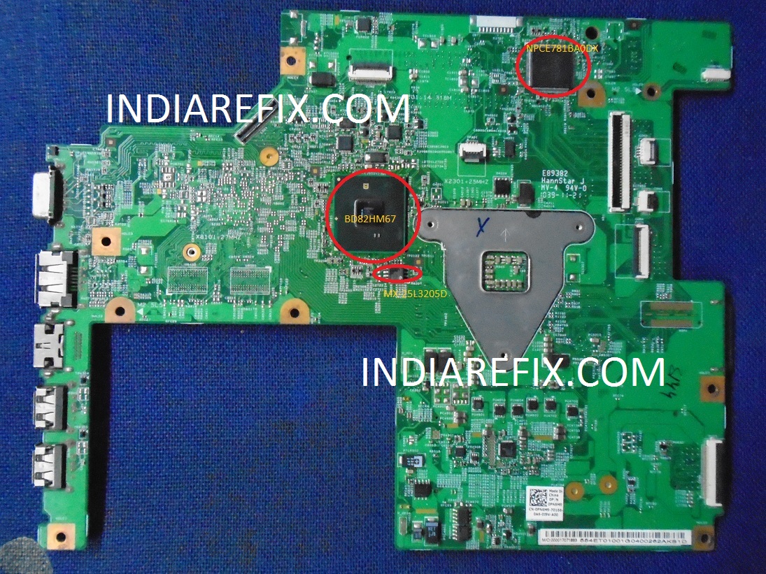

Make/Model- Dell Vostro 3500
Motherboard Part No- D/P-0PN6M9
Processor Type- I3 1st gen
Ram Type “DDR3
Problem “Dead
Diagnosis- I/O Faulty
Process-
Found Motherboard Rough Repair (PCH,I/O,Bios Rough Repair )
Voltage checkout 19V+ve Working Charging Voltage Working And Step-down working then change PCH U20001 (BD82HM57) Replace Motherboard On But No Display Then Reprogram Bios U6202 (MX-25L3205D) But No Display Motherboard At last Change I/O U3701 (Nuvoton NPCE781BA0DX) After Replace I/O Motherboard Coming Display Job Work Done ..
